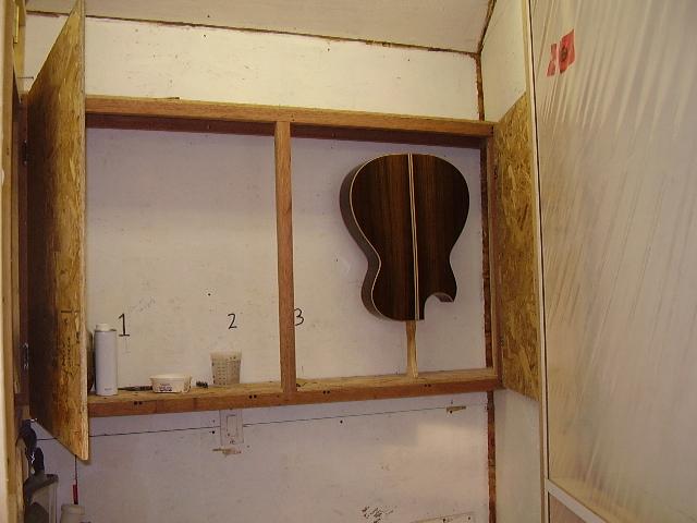

I think to solve your gnat problem, you need to have a dedicated booth of some sort first off to contain the fumes of the over spray and than to keep the gnats out. Also think about building a cabinet that you put your bodies and necks in after you've sprayed, kind of like this
This cabinet of mine can hold two guitar bodies and two necks. Mine isn't sealed off from the rest of the booth but I don't have gnats.
