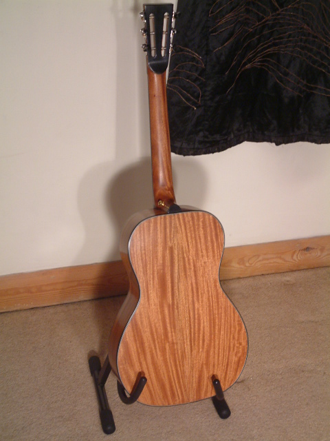

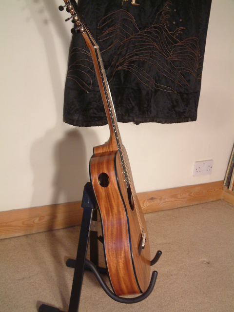

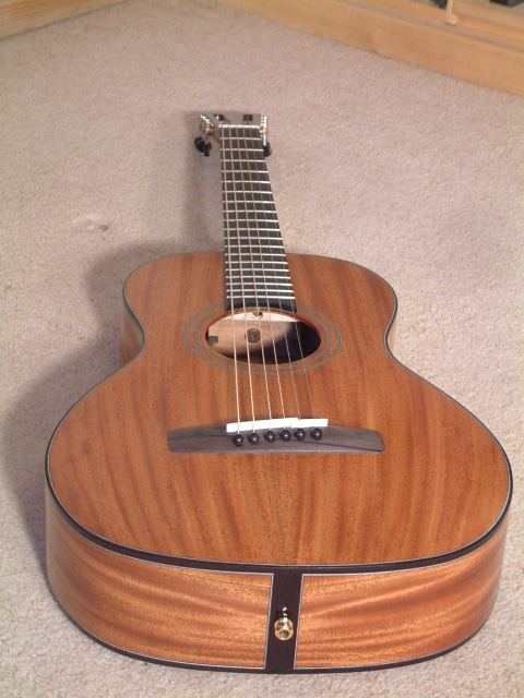

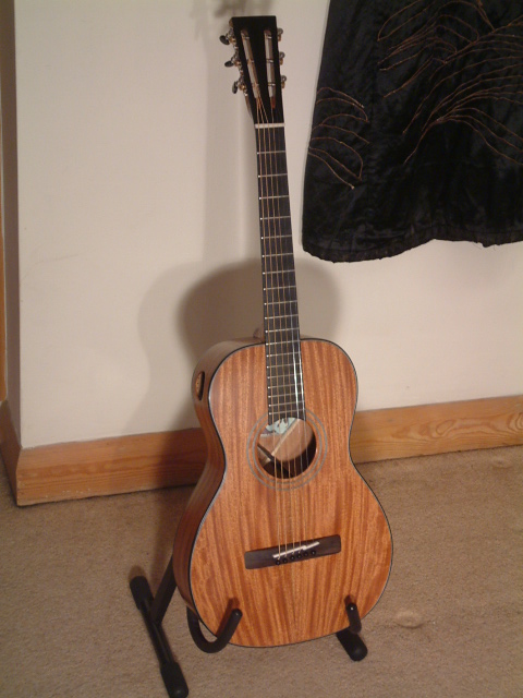

Ok here is the source of the sound - a Cuban mahogany parlour/Concert/O sized 12 fret body join. This was a fun comission as my very first comission four years ago was the same guitar.
Specs:
Top/back/sides/neck are figured Cuban mahogany, plantation grown in Micronesia. The neck is from the same block as the sides. The binding is ebony with bwb top/back and side purfling, ebony end graft, heel block and ebony venner on the front and back of the headstock. The bridge is Old Rio rosewood with split bone saddle and ebony bridge-pins. Scale length is 624mm (24.57"), lower bout width 335mm (13.19"), upper bout width 240mm (9.45"), waist width 205mm (8.07") and maximum body depth 95mm (3.74"). Tuners are Waverly's with ebony knobs. The finish is hand rubbed pre-catalysed lacquer over Z-poxy on the body and tru-oil over Z-poxy on the neck:

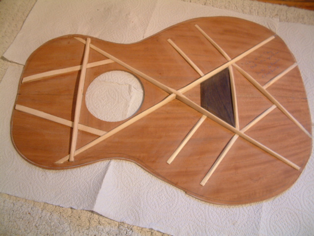

Bracing is my usual "triabolic" with hybrid X braced back with cf flying buttress braces:

Very nice Dave, sounds as good as it looks too. I didn't post a guess as I remembered you saying you were building an all Cuban.

She's a beauty Dave and I really love the bracing - very clean, minimal, and resonate looking to me.
This guitar also has what I call a "best friend" quality to it in as much as it just looks like the kind of guitar that one would always wish to pick-up and relax with.
Do you know what it weighs?
I did guess the back and side woods correctly at being Cuban Mahogany.
Outstanding guitar Dave but that is never a surprise from you mon.
Sounds like an advanced system. I've been using either my "hyperbolic" (you can't say enough good things about it) or my "diabolic" (the baddest system there is).

Thanks. I haven't weighed it completed, but I sort of weighed the component parts as they were completed and it should be a little over 4lbs. Definitely no competition for the Old Timer early 1900's original in the centre of the photo of three that clocks in at 2lb 10oz!

Dave going by it's sound I expected it to weigh in closer to 3 lbs..
I am unsure as to if it is the players excellence or the freeing up of the upper bout of the top that leads me into thinking that is what I hear.
There is also the question "How much am I hearing what I want to hear?"
A few days ago I had a post all typed up but by the time (2 a.m. p.s.t.)I hit the post button the forum was down and my post was lost.
There are perceptions I hold and questions I would like to ask that require some care as to not appear pompous or critical so I am hesitant to do so. I fear not presenting them properly.
In the previous thread I made the statement,
listen to how the top responds to differing attacks, if it was spruce it would have to be way overbuilt.
that could easily be construed as criticism of the sound of this guitar. It is actually due to my perception that mahogany tops require patience in design philosophy and in the expectations of the player/owner.
I believe that to properly build a mahogany topped instrument it will have limited bass response for a while and that if it is built to have it right off the git go then it would be built to lightly.
I also believe they can take as much as a year or two for the bass response to develop. Another belief I hold is that they more than other guitars do not really come into their own until 5-20 years have passed.
Dave what I think I see is a guitar that is built in such a way that i will age into itself perfectly.
These statements really do seem a bit pompous but they are my perceptions and unless I put them out there to be challenged I will not learn much will I.
Dave is the top .125-.130 and even in thickness?
Do you think it would be possible to lighten the neck block and buttress anchors without compromising their structural integrity?
Why lime for the tail block?
I feel all mahogany construction and small bodied instruments have an special affinity?
Yes that means I thinks that D 15s are a mistake.
Do you feel comfortable discussing your thoughts on all mahogany construction and body size?(I would actually like to include cherry, walnut and koa)
Thanks in advance for your patience!
               with respect,
                          Kirby
"It's a Tone Faerie thing"
PostPosted: Sun Dec 09, 2007 7:51 pm
Kirby,
I've no problem discussing my thoughts on all mahogany construction and body size, but it is based only on two guitars - both small bodied, and both based on a killer 80-90 year old guitar but done X with bracing rather than the originals ladder bracing. I have made a Cuban mahogany topped Weissenborn-style guitar which sounds really nice too.
Firstly Candi specifically wanted an all mahogany small bodied guitar as the size is comfortable for her and she wants a guitar that will change and mellow with her as they both age together. Even when I am building spruce topped guitars, I am trying to build them for a sound potential that will be maturing one or two years down the track - as you say probably longer than this for mahogany tops. I probably build my tops thicker than most American (and probably European builders)as I believe that this helps set the trebles. I then thin out towards the edges and back of the lower bout area, but work with each individual piece of wood until it gives the flex and response that I think will work best - again I have only been making guitars for 5 years or so so this is the very first part of a very long learning curve. This top started at just over 2.5mm thick but is thinner in the upper bout and around the perimeter of the lower bout. I don't measure but go on the feel and response.
I also put bigger arches in my tops than most other makers, as I really think that this makes the tops "alive" and gives great volume and projection - I think of them as drum-heads and a sytem under tension that reacts when disturbed by the strings. It also helps the mids, but you can get a slightly "nasal" sound which dininishes as the guitars open up but I am still working on the bracing profiles to minimise this.
Part of this guitar's weight is in the neck, which is Cuban mahogany to match the body, has a deeper neck profile to suit Candi's playing style and has a 2-way truss rod installed. With the tuners the neck weighs just under 2lb.
As to your other questions:
Structurally you can certainly have a much smaller neck block with the butress brace/free flaoting neck system and builders like Rick Turner and Mike Doolin use much smaller ones than I do. As for the upper bout, it's not a case of having no bracing but having bracing that lets the whole of the top move to produce the sound that you are aiming for. I still use small A frame braces on either side of the soundhole re-enforcement that tie in to the neck-block, but this is for the soundhole area integrity. Also I have an upper transverse brace that arches the top area, as when this brace goes on the tap tone of the whole top becomes incredibly "alive". However this brace is shaped for the top's sound rather than structural integrity.
I like the stability/strength weight of lime and the fact that it can be carved/planed easily in any direction (it's the same family as basswood).
I have only worked with walnut and cherry as backs/sides and koa as a binding, but I have used maple (English Sycamore) as a top on a travel guitar and liked it. I suspect that a lot of woods would make "good" topwoods if you work with each piece of wood and know the strengths/limitations of the sound you are trying to shape - certainly I've seen Michael Payne say that his koa topped guitar is his favourite fingerstyle instrument. Heavier woods like the rosewoods would be a "challenge" though.
