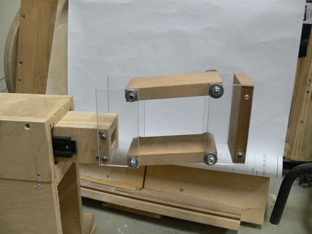

Thanks all for the suggestions.  Here's my attempt using Lexan:

PostPosted: Wed Dec 05, 2007 5:32 am
Posts: 1012
Todd, I have nylon washers between the lexan and the hardwood arms. Thanks
