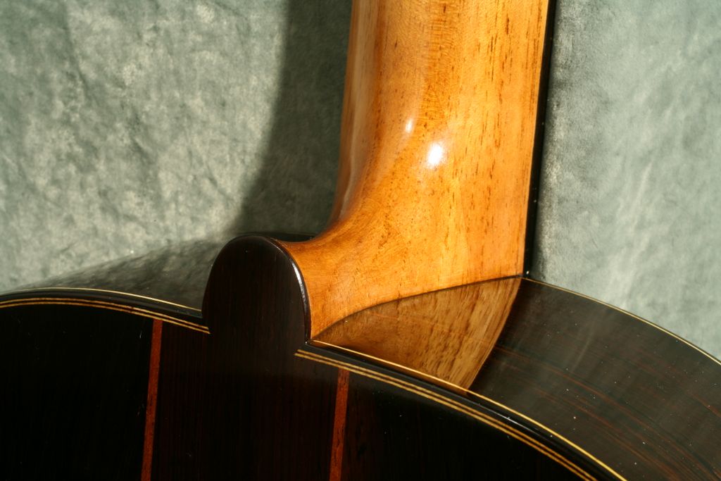

I use a pad about the size of pecan (unshelled of course <G>) and apply straight pulls next to the heel edge on the side, along the heel's edge and up and over to the other side of the heel and  again on the side next to the opposite heel edge. I then do straight pulls back on either side to overlap the side pulls done previously that left off beyond the waist on the treble bouts. I also sand (360) between sessions and polish at the end.

Looks good DP, that's the results I like but it takes me several days (maybe even a week) to get there.   I've tried the straight pulls but I always get fine streaks running parallel to the heel. Looks like you have overcome this problem.
I'm interested in your technique--need some more info, hope you don't mind a few questions. Were you able to complete this in a single day? You sand between sessions with 360, how long do you wait before sanding? What do you polish with?

"Were you able to complete this in a single day?"
No, certainly not. My polish is a four to six week process with many bodying and leveling cycles in order to build/fill the surface.
"You sand between sessions with 360, how long do you wait before sanding?"
I use non-loading paper and do not attempt to completely level the surface in the earlier phase of the work, just to knock down any lap marks etc.  Once the surface is well developed I usually go to 400 paper. Often I can sand the next day but often a week will go by until the next session.
 "What do you polish with?"
I use the series of Meguiar "Heavy", "Fine" and "Glaze" compounds to finish. Sometimes I will polish the surface just as it comes off the pad, sometimes I may use a little 600 to level it a bit, depending.
