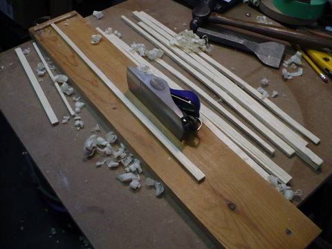

Does anyone besides me seem to get more waste than brace, when planing split pieces?  I bought the Italian Moon Spruce brace stock at the Swap Meet, split out some pieces from one hunk that looked pretty straight. Now I = find that coming up with nice straight and vertical grain creates as much waste as brace.  The waves in the grain are limiting the length of the straight braces I get out of each piece.
As I look at the picture, some of them look crooked, but I think the angle is deceiving.  I'll check them.  But the grain is straight, and there is no runout in these.

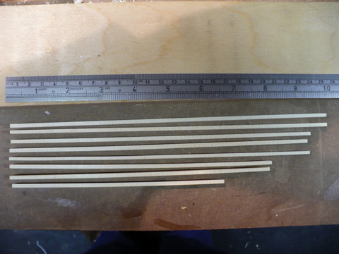

Grumpy, that's exactly what I did.  I think the wavy grain in this piece of spruce was the real culprit.  Those pieces to the right of the board are all split pieces.  but each has a hump in the middle that limits the length of the braces you can get.  As you can see from the last pic, 10" is about max, and most won't get that.  Some I did what you suggested, but most took a while to get a flat along the grain.  Funny how things don't always split the way you think they should.
Bruce, that's exactly what it is.  I knew I needed something dull, so as to not influence the direction of the split, and figured it was as good as anything.  I ground a nice dual bevel on it, and rounded off the sharp edge.  It is just enough of a wedge to pop the split open.  Maybe I should be using something else.  I also have a flat 1/8" thick blade there, also with a dulled double bevel.  I use it when the pieces get smaller.  You can barely see it under the hammer and the other chisel.
