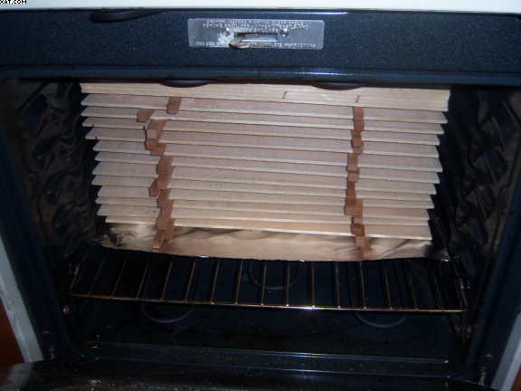

On baking day, how may half tops do you do per bake (200degrees @ 1 hr or do you have to increase the amount of time based on the number of tops?

I can fit three in my oven. I think what matters is that the air temperature is right for all of the wood. I have a convection oven so get good air flow and a consistent temperature everywhere. Make sure you don't get the piece at the bottom blocking air flow and being significantly warmer than the piece at the top. I bake at 195 for 2.5 hours.
David White, Toronto
PostPosted: Sun Nov 25, 2007 7:12 am
Posts: 1384
I have a gas oven and I can fit 3 with bracewood tucked around them. I put one shelf as low as possible and use baking sheets and foil to cover areas where the heat would get through hoping it regulates it a bit evenly above. I also crack the door just a bit. I put a thermometer about halfway up and adjust the oven temp so it reads right around 200 and I usually bake for 2-3 hours. With some spruce it doesn't move at all but others, especially some of the newer growth red spruce, i find I have to sticker. Once it re-acclimates it is flat again but it will warp some out of the oven. A nice pyrex dish on top is usually enough weight to keep it okay in the oven. A convection oven is probably superior for this application. I would love to see if anyone has built a little heating box that works well too. My roomates don't always love giving up the oven for a couple of hours! They do like the smell though.

You don't need an oven to bake your tops. An insulated box and a couple of light bubs will do the trick. Boyers use a hot box to cure laminated bows. This article shows you how to build one.
