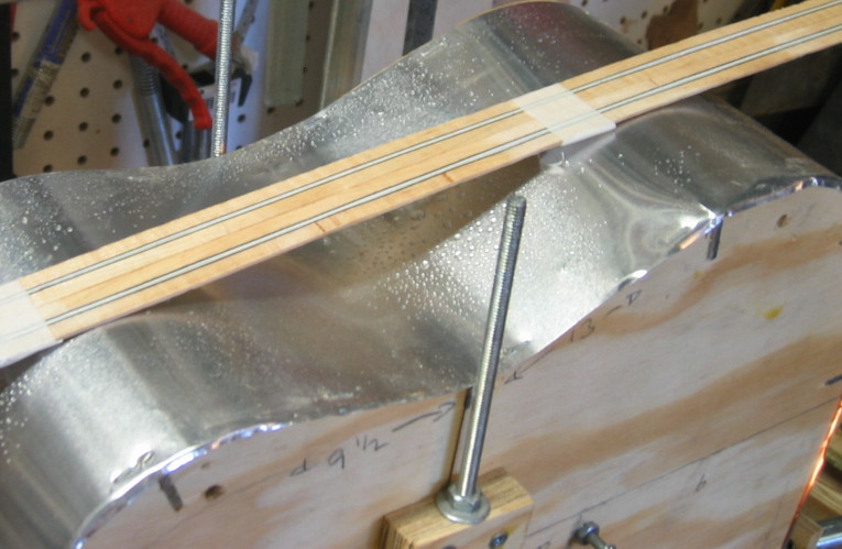

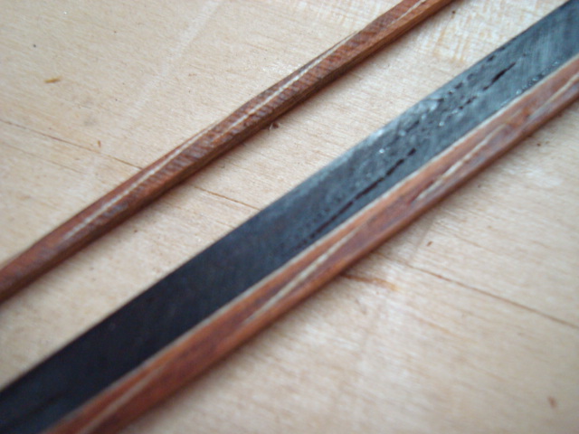

Posts: 241
Here is what I've been bending up today: These are Brazilian rosewood with a side purfling made up of maple and Brazilian rosewood veneer. I made these first cutting and sanding the 2" X 30" X 3/16" slab of Rosewood. A thin .3mm maple veneer was glued to the bottom of the rosewood, then a prepared lay up (sliced from a thicker lay up and sanded to 1mm) of the Rosewood/maple "half" herringbone, followed by a final layer of .6mm Brazilian rosewood veneer. Final strips were sliced on a Proxxon table saw and come off the saw ready to work. The matching back purfling is next to the binding.
