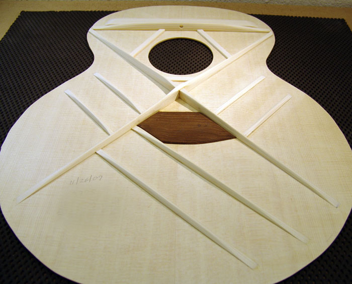

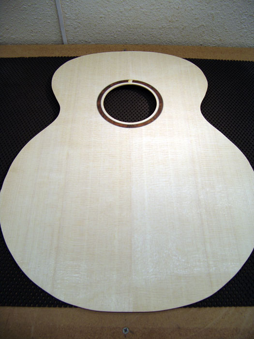

It snowed here today which made is a great afternoon to spend in the shop finishing the SJ top for #15.
This is a very nice piece of Lutz that had some bear claw before I final thicknessed it and now it has some squirrel claw
Take a look!  By the way the written message on the inside of the top has been cloned out to be politically correct so you will see a blotchy look there.......
Thanks for looking!

I forgot to add for those of you that weigh your tops this SJ top weighs in at 109.2 grams.
Thanks!

What, no scallops?
Is this a Post Somogyi top? (duck and run)
Hey Hesh, you missed the glue all over the side of the first Tone Bar!
Just kidding... Nice work, why not date it? And sign it?
Never weighed a top.
Hey, what's in the rosette?
And... what's the bridge plate material? Details, we want details....

Looks great hesh.I really like the SJ shape.I`d like to make one on my next build.Is this the same as Michael`s
plan that`s available from the forum?
                       James

Thanks folks!
Bruce buddy who is S***g**?  Never mind
Scallops - yum I love sea food!
The bridge plate is BRW (rift sawn) and the bracing is Adi.  The Rosette is BRW as well and the sides and back on this one will be Honduran mahogany (waiting for praise from Colin).
It is signed and dated but the message that I wrote was rather personal so I cloned it out for OLF consumption.
The last 3 guitars had the same message added........
James buddy it is indeed Michael Payne's excellent OLF SJ plans available here from Lance and Brock.  This will be my third SJ and since I had not built one in a couple of years JJ suggested that this be an SJ.  Thanks JJ!!!
Andy snow sucks.......  Wow 70 degrees and 45 RH - perfect!!!!!!
Max my friend looking forward to seeing your latest.  No word from David and last time I asked him about it he was going to check with the boss and get back to me.  No word yet and since we are getting close to the holidays I doubt that this will happen this year.
Terry and Greg it is indeed 109 grams which is light for me but my last top was 124 grams and others have been similar.  I just build tops very light and remove any thing that I can cut off that is outside of a triangular profile.  My bridge plate is smallish and .088 thick and the top is around .105 for now.  the X intersection is slightly under 1/2".
Mike buddy maybe mouse claw?

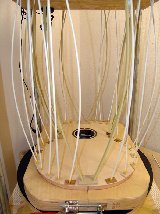

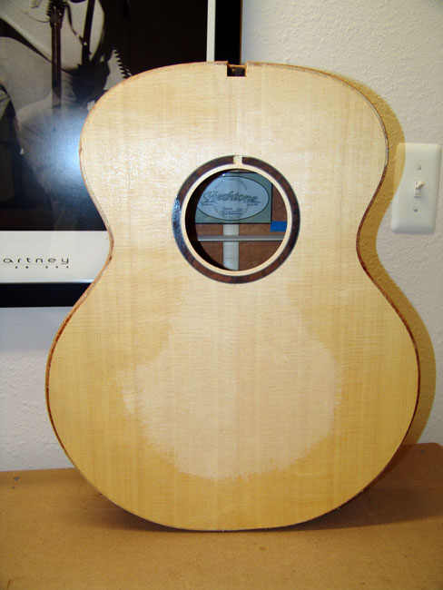

Well I was on a run so at 5:00 I kept going and routed out the inlets in the "kerfed linings" for the upper transverse brace and the upper X legs, leveled my upper bout, and glued the top on.  So this puppy will be out of the mold tomorrow.  Take a look.

Hesh - very pretty top. This is definitely my favorite point in the build process - although mine these days have a very different, fan brace arrangement, and your top is very heavy!!

What width bracing stock do you use? And do you think you'd use anything different if you scalloped rather than parabolic'd

Andrew I use 1/4" wide braces.  It's been so long since I scalloped a guitar now that I don't know what I would use anymore

Very tidy work Hesh. I do like your bracing profiles. What is the width of the X braces where they meet the top?

Thanks John - I think you are asking the width of the X-brace stock?  If so it's 1/4" and at the intersection they are just under 1/2" high.

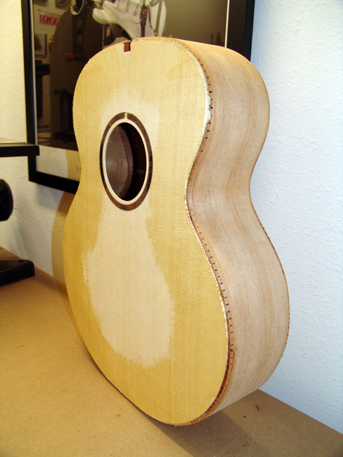

Well I had another great shop day and cut the binding and purfing channels and hit the top with a prophylactic coat of shellac to avoid tear-out when removing the tape.  The purfings (Mahog-O-Lam from Uncle Bob) are bent and the bindings are thicknessed to .090 and ready to go in the bender wrapped in craft paper and lightly misted.
Take a look.

Hesh...if you don't mind, what kind of shellac do you use for your prophy coat? Is it an off the shelf product? Thanks.

Bill it is Zinnser Seal-Coat wax free.  I am not sure about this but I think that it comes wax free and with wax so be sure to get the wax free stuff if you go this route.
BTW I keep two cans here with the first for utility things where I am not concerned about contaminating the contents with dust.  The other can I have used and will use again for french polishing.  This stuff worked as well for me as a French polish as the flakes that I bought and dissolved in Everclear.
It's great stuff - highly recommended.
