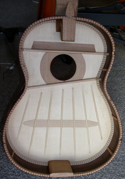

Here's a look at the insides. Transverse bars are Sitka Spruce, Soundhole reinforcement and fingerboard patch are Western Red Cedar, bridge patch is Port Orford Cedar and fan braces are Swiss Spruce. Back linings are Spanish Cedar and top linings are Sitka.

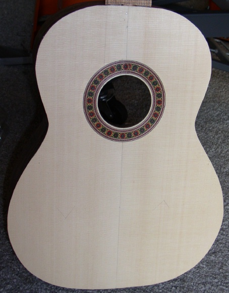

Here's the top.

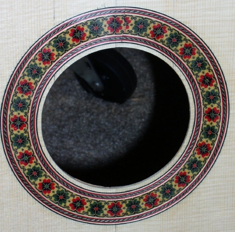

Closeup of the rosette.

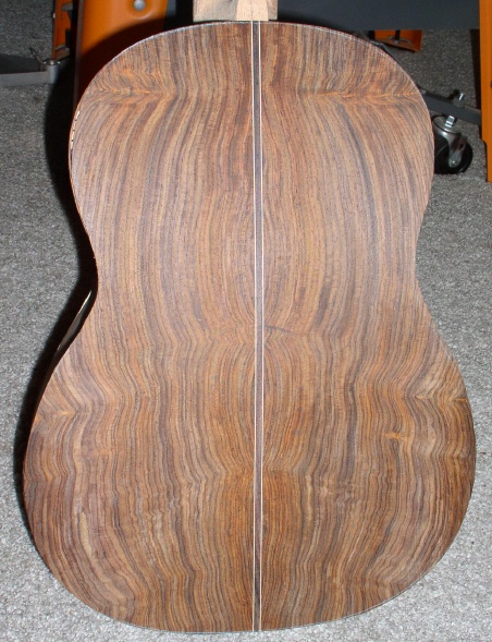

Here's an inside look at the back. Braces are Spanish Cedar. The label is protected with plastic ala my friend Hesh.
Here's what the back looks like from the outside.

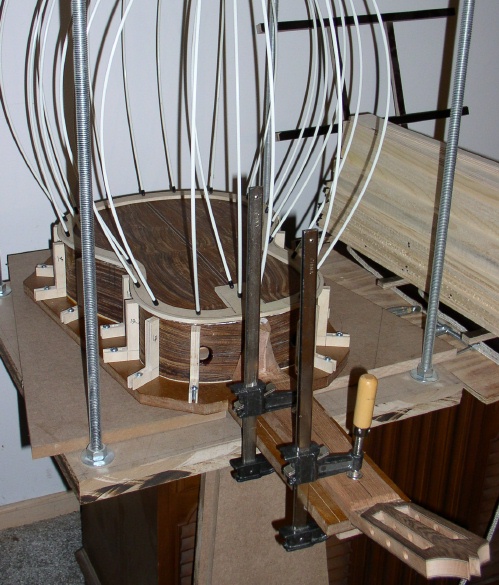

Right now the back is going on.
