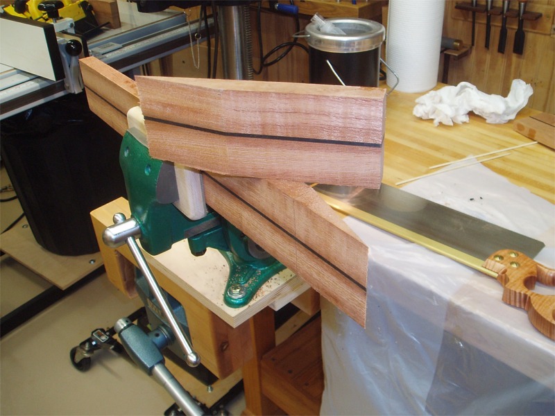

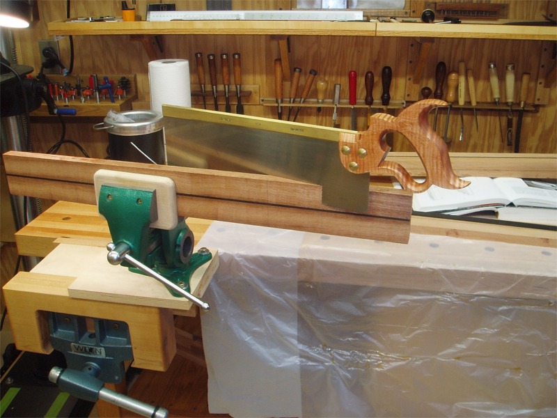

I find a scarf joint one of the easyest joints to do it only takes me 10
minutes to cut free hand with a jap pull saw and then true up by hand.
I think it would take me longer setting up a jig than it would for me to cut it
by hand.
But thats just me and i only make a small amount of guitars.
If i was making 40 a year i would no doubt jig up to the full but in the mean
time my good old japanesse pullsaw serves me well.
Joel.
PostPosted: Tue Nov 27, 2007 9:56 am
Posts: 606
Mark it, cut it, ~ 5 minutes
