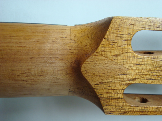

I must admit that I really like the way these joints look.Anyone using it for steel?

DP, thats a very interesting V scarf. How is this done?
-j.

The male and female portions are marked out with patterns along with a sliding bevel guage to mark the angle. Cuts are made with a back saw and final fitting is done with a chisel. I use a long bar clamp to glue the head and neck shaft together.
There is an excellent article on Geza Burghardt's method of doing these in the number 63 issue of the 2000 GAL quarterly.
PostPosted: Tue Nov 27, 2007 3:33 pm
I'm pretty sure there is a "V" Joint tutorial on the Tutorial Page that explains it well.

HERE is the V Joint Tutorial by Joshua, posted on the OLF Tutorial Page.
