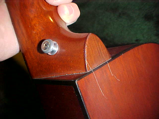

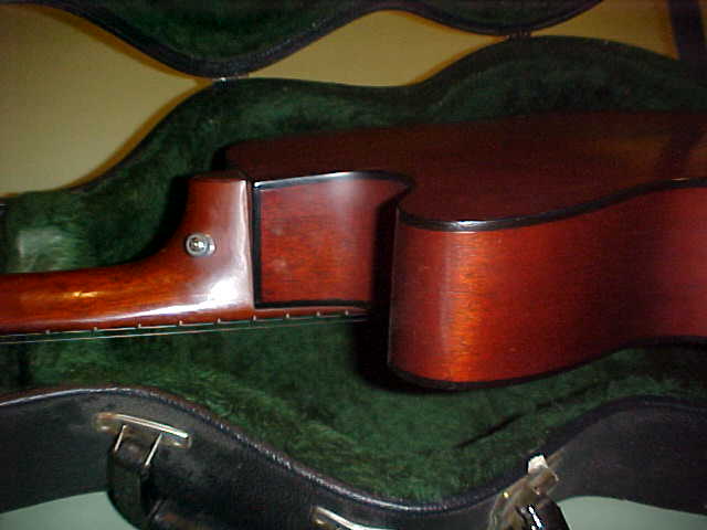

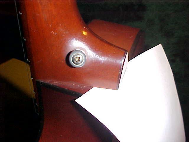

Just wanted a few of you experienced Martin folk to tell me what we have here. Is this a glued MT joint with a bolt? As you'll see in the pics it has a tiny gap.

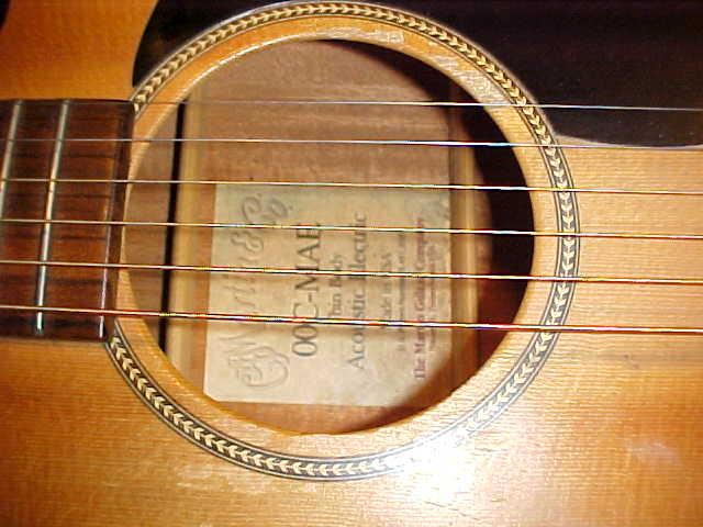

Inside is a small wood lable cover on the neck block which has the serial number on it. Is there a bolt under that wood cover?
This is a Martin 00C-MAE made in USA. On the paper lable it says Thin Body Acoustic Electric. Serial # is 707363.

In the last pic you see two scratches from the body onto the neck heel. Those appear to be buckle scratches, not cracks.

Pull the cover and tighten up the screw. It should pull right in. It's a #3
phillips head.

Tele didn't do too well, but the Martin neck is tight now!
David, While I hadn't read your post above, the only think I could think of was a single edge razor blade. I didn't know it had two sided foam tape. It took some prying, but it came clear. The foam seperated half and half, I added two strips down each side to put it back.
The phillips Screw was visible pretty as you please. About five re-grips on the limited space and it was all I could possibly turn it with a screwdriver. No visible gap now, which was .008".
I tuned it up and checked the action at the body join before and after. .160/.130 before; .150/.120 after so there was some improvement. I hit the truss rod just a bit and left the strings loose overnight. That may help it straighten a little. Not holding my breath.

No Todd, you're right, or at least that's what I've done a few times. The
neck angle can be brought back pretty easily just with a bit of sandpaper
flossing. The only risk is that the extension really isn't on that well, and
can pop off pretty easily with the flexing back and forth during the
flossing. It's a good solid .006" layer of white glue in the small area with
finish removed, which fortunately tends to come apart quite cleanly if it
does pop loose. It's happened to me twice. If you don't want it to come
loose you can just put a clamp and block on the extension, or just reglue
it if it does come loose.
And you're also right that Martin claims to use the screw just to hold
things in place while the glue dries, but I don't personally buy it. I don't
feel a straight MT joint like that has the surface area to hold, especially
since it would be relying on shear strength. I've seen a lot of those come
loose, and of the dozen or so of those necks that I've pulled I've only had
to use steam once. The others were either already loose, or worked loose
quite easily with a bit of wiggling. I view it as a straight bolt-on neck, and
don't give the glue much credit in the joint.

The thin body, just doesn't seem as strong as a deeper bodied guitar. Plus, you should see the case, like someone stepped in the middle of the thing.
I'm wondering too, was the guitar in there when that happened?
