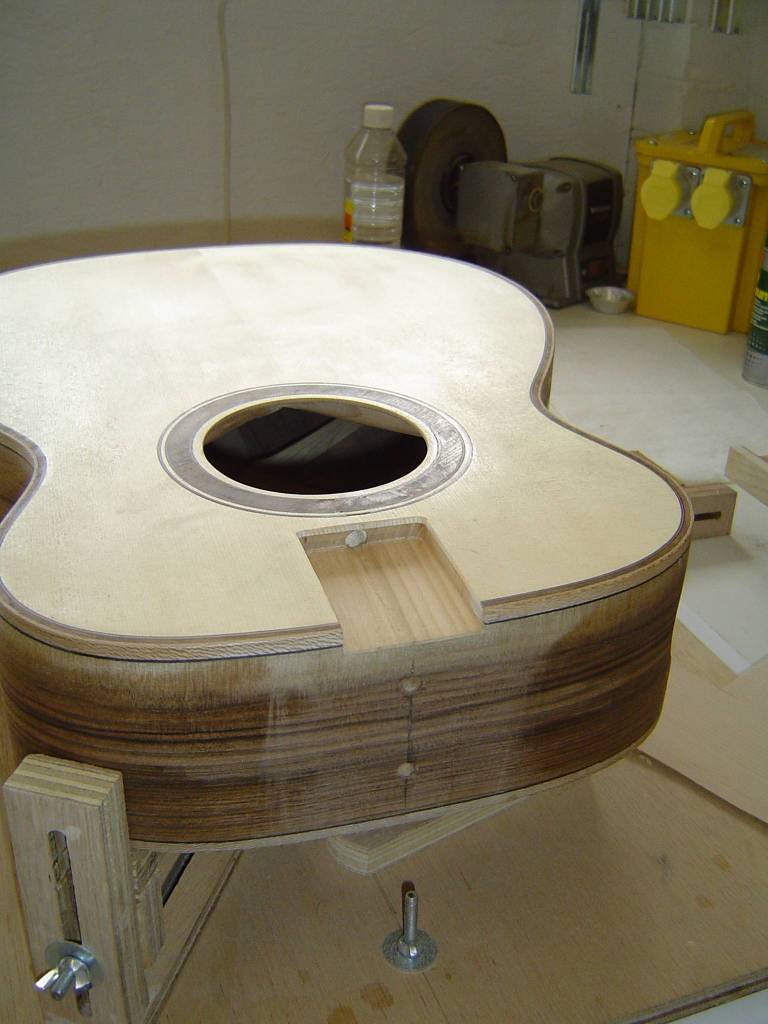

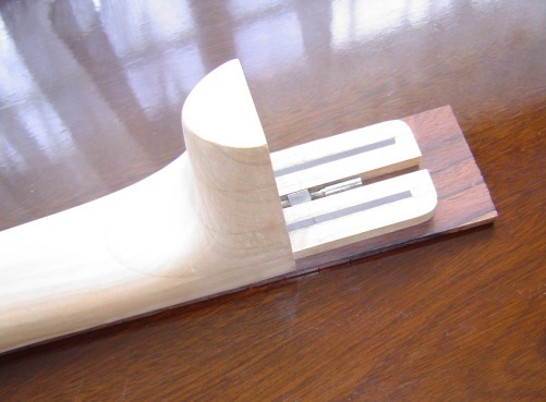

I use a bolt on but joint with the neck glued to a fingerboard extension not the top. I've never found it necessary to bolt this extension down. Two bolts and the neck comes off.
This:
Just fits into this:

[QUOTE=Colin S]I use a bolt on but joint with the neck glued to a fingerboard extension not the top. I've never found it necessary to bolt this extension down. Two bolts and the neck comes off.
This:
Colin[/QUOTE]
i like this form. Isn't this the way most Taylors attach? Also, is the fingerboard extension part of the neck itself or is it just attached to the neck? It looks doable for the kind of tools i have
PostPosted: Fri Nov 23, 2007 9:20 pm

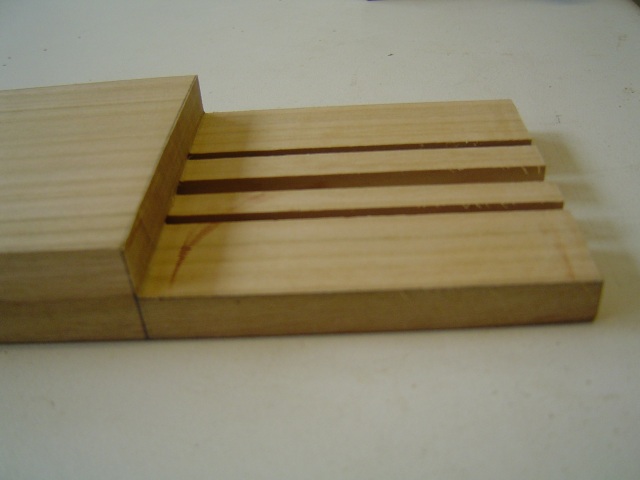

Yes the extension is a continuation of the neck wood, so the fingerboard glues to the same piece of wood all the way down, avoiding any hump.

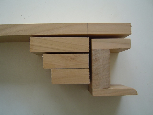

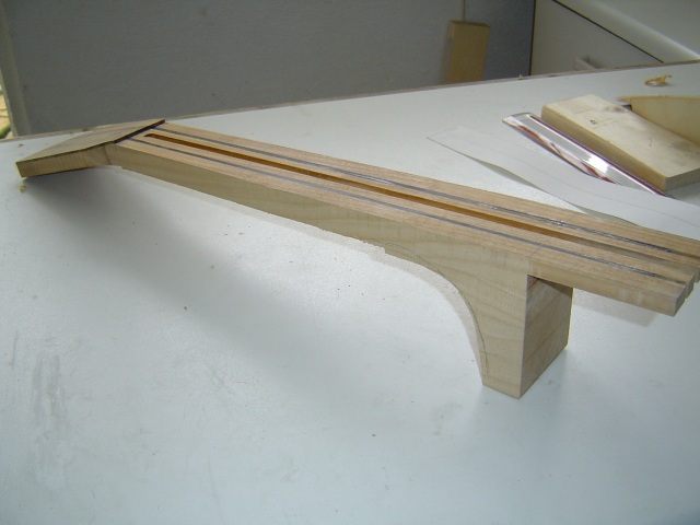

These are the neck components.
First the extension is thinned
Then the stacked heel is glued together then glued in place. I have already cut the stacked heel to the correct angle. This has just been bandsawn to a rough outline.
Then the stacked heel is glued together then glued in place. I have already cut the stacked heel to the correct angle. This neck has just been bandsawn to a rough outline.

PostPosted: Sat Nov 24, 2007 5:10 am
is that a dovetailed joint where the fingerboard extension fits into the routed out part of the top?

Colin,
I really like your technique and would be interested in having a go. But bear with me, because I am wondering about a few things.
1.) What are the dimensions approximately of that heel block? It looks like that foot is a good 3 inches or so? Does it get glued to the back then?
2.) Does the part of the heel block the gets routed away result in a pretty thin "tongue" supporting the top?
3.) I am guessing you eliminate the upper graft/popsicle brace with this design?
Thanks in advance
PostPosted: Sat Nov 24, 2007 9:36 am
A few answers.
With a 25' radius and a 1.5deg angle on the heel, the pocket just follows the top.
No the fingerboard extension is just a non-interference fit tenon, a few thou smaller than the pocket.
The top extension on the heel block is about 75mm and comes to just short of the cross brace on the top. The foot is 80mm and is the steel string equivalent of the Spanish heel, so yes it gets sanded with the dish with the back of the rims to the 15' radius and is glued to the back.
The top extension on the heel block is 18mm thick, and that on the fretboard extension is 9mm thick, so when the pocket is routed in the heel block there is still 9mm left under the fretboard extension and 18mm to both sides.
No popsicle brace.
To me the heel block is the heart of the guitar, every major component is joined to it, neck, back, top and sides. It is the first thing I make.
