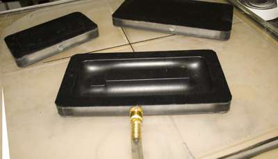

OK, a few people mentioned in the vacuum tools thread that they'd be interested so here's the offer on vacuum bridge clamps. They can be made in guitar or UKE sizes.:
If eight to ten will sell, then I can do them at $50 each. If it was 15 or more, I could do them for $40, but that's a lot of bridge clamps. Quantities under eight are doable, but the pricing goes up pretty quickly, so we'll figure that out if it happens.
The clamps are 3.5"x8.25" inside and 2.5"x5.25". They're made from 3/4" acrylic plate with a 1/8" neoprene foam gasket on the bottom and a neoprene vacuum membrane on top. They come fitted with a barb of your choice for 3/8" or 1/2" hose (outer diameter). And they really suck!

You could consider it that. At one point, I offered these as retail items in an online store but I don't generally hold stock on items and the setup ended up eating up any profit on making them. So, to make a profit on them I need to batch them.
Shipping would be cost plus $5 for the packaging. I can get more of both the gasket and the neoprene sheet. In theory, you should never really wear out either of them (especially the gasket). Replacing the neoprene is just a matter of slicing off the old stuff with a razor blade and gluing new stuff on. At the price, though, you can probably just buy another one in fifteen years :)
Rod:
Currency doesn't really matter. Pick whichever one is cheaper for you on the day you pay.
They don't need to be curved on the bottom as, over the width of the clamp, there's only 0.05" of bow even in a 15' radius (and 0.125" of gasket). It's good on anything up to around probably an 8 or 9' radius, which would be one heckuva dome. I can make them with thicker gasket, as well, if someone's doing something really crazy with them, but it'll cost a bit extra.

The interior of the clamp is the dimension I put in the original message at the top. You need at least that much area and a smidge more underneath the clamp or you won't get a seal. If you have enough space on your uke top (3.5" by 8.25" plus at least 1/8" all around for a seal) then there shouldn't be a problem.

Vacuum bridge clamping strikes me as an example of thinking that higher tech must be better. With a good pump and seal, you won't get more than 10-11 psi, which is a small fraction of what any glue manufacturer recommends (OK, they all recommend much more than is really needed, but in any case you can easily get 3-4 times as much with clamps). Plus the vacuum will tend to pull the glue out of the joint. I won't dispute people saying they haven't had problems, but they are having success in spite of the clamping system, not because of it. Why give up your margin of safety unnecessarily, when it is so easy to clamp a bridge in the traditional way?

I've done a few lattice-braced tops (where the lattice runs over the bridgeplate) and just find it a PITA to make up a caul to properly fit, and then stick it in there, and remove it later. I was also thinking (while recently working inside a guitar with CA and transducers) that it would be a lot easier to install the K&K pickup transducers before gluing on the top, if they were part of the plan from the get-go.
For situations like that,I thought it would be handy to get/make a bridge vacuum clamp. I agree that the clamping force with vacuum (perhaps 80lbs total?) is not as great as with several screw clamps, but it's comparable to using 8-10 go-bar sticks, which seems like plenty to me.
I also hate using clamps through the soundhole, as it's easy for me to 'ding' the soundhole edge- I'm kinda clumsy, I guess.

I think it's an example of people considering the forces at work and choosing the simplest solution. On a properly fitted glue joint with glue properly spread on both mating surfaces, the goal of the clamp is to push the mating parts together while evacuating ALL excess glue except that which is required to coat the surfaces. The strongest glue joint is a chemical bond, and that requires the thinnest glue line possible.
Clamping pressure accounts for errors within the parameters above. Too much glue in the joint? More clamping pressure to evacuate it. Poor fit on the joint? More clamping pressure to force the parts together.
I agree that a margin of error is lost, but the margin in this case is accounting for sloppy work, not the requirements of a good bond on a properly prepared joint.
