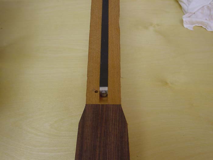

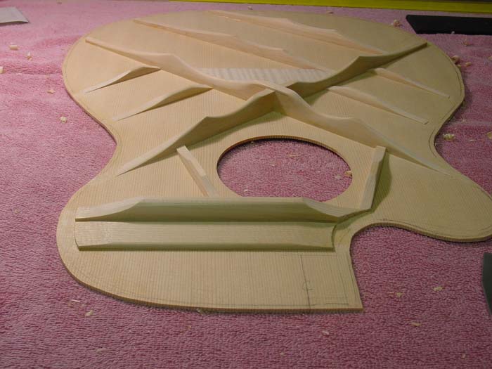

Hello All,
Ran across a situation yesterday.
First, some information.
This is a Martin neck (2nd), a Martin fret board, and a Martin truss rod. The spruce top measures
right at 0.100".
By the pics, you can see that the top does not fit between the truss rod and the bottom of the fretboard.
I’m assuming that a simple notch out of the Top will remedy that problem, and I know I need to
drill a hole in the brace next to the sound hole. However, I’m really concerned to what I should
do about the first brace in the upper bout. It looks to me, that the truss rod adjusting nut will be very
tight to the bottom of the Top.
Is this a typical situation? If so, will I need to chamfer in a trough in the foremost upper brace?
Also, what do I do with the black strip that came with the truss rod?
Thanks in advance!

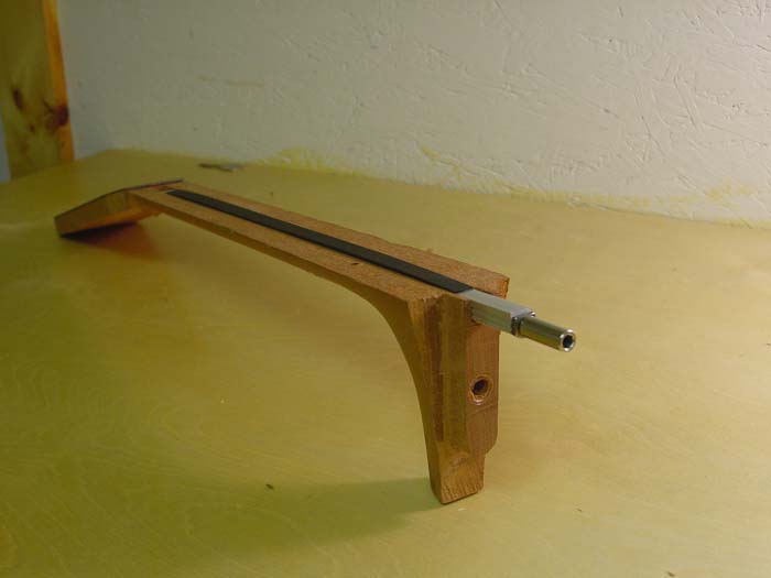

After reading your post, I decided to make some measurements, and take a closer look at things.
You’re right about the fiber cap plus the offset giving room for the nut. Though, it still looks like
the nut will be right up against the top. I suppose that’s OK, but, I will still need to deal with the
flat (transverse?) brace.
I like your suggestion to make the channel deeper, however the depth of the channel is 7/16" and
the depth of the neck, at the point where the curvature of the heal begins, is 11/16". That only
leaves about a 1/4" of neck under the truss rod. Perhaps that’s OK.
Grumpy, Or should I say Mario!
From what I can tell, the rod is in as far as it can go.
The following are some measurements, and a few more pics, to help explain.
The neck is for a 14 fret guitar.
Total truss rod length = 15-15/16"
The truss rod extends from the heal joint 2-15/32"
The neck block measured from the body inward is 1-3/4"
Right now, its looking like, all I need to do, is thin down that flat brace to about 1/16" thick, and drill a hole in the taller brace.
What do you guys think?
PostPosted: Sun Nov 25, 2007 7:02 am
Posts: 1667
Cut away the top and slice through that popcycle brace....
then do as Todd says. Drill, and scoot it up to the nut by chiseling. I drill a 1/4" access hole after the body is closed, using a long spade bit. Nothin' to it....
PostPosted: Sun Nov 25, 2007 7:25 am
Posts: 499
Ok! Just so I know what I’m doing here.
The popsicle brace is the flat one?
Drill the hole through the upper transverse brace.
Chisel out enough wood in the channel of the neck to allow the end of the truss rod to line up
with the fretboard side of the nut. (not under the nut, right?)
After the body is closed, trim away top, to allow room for truss rod extrusion.
Unless I’ve missed something, I think I got it!
Thanks so much Guys!
Robert

Sounds good. I actually run mine right under the nut, and have, on occasion, even ground down the end of the rod to the headstock angle. I feel these rods work best when they're set as far forward as possible. I also want the least possible rod extending out into nowhere, since that can't do anything good, can it?

Is that a curly maple bridge plate, Robert? If so, it's not a good idea; you would be making the plate more prone to chipping out, as well as less stiff.

martin notches the top and they use a neck block that has an extension to suport the cut top. and truss rod.

Also, after doing a little more checking, I found, if I do as you suggest, and bring the truss rod all
the way underneath the nut, the extrusion becomes completely within the channel of the neck. So,
that’s what I’ll be doing! Thanks Mario!

Mike,
You are right about the extension. I had to make a choice though. Either cut off some of the neck
block extension, or remove a large portion of the popsicle brace. I chose to cut the neck block.
It seemed the right thing to do, by leaving the brace intact.
