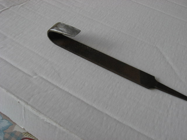

Here is a tool I made with an old file. Heated, bent, sharpened. I think I got this from Frank Ford
