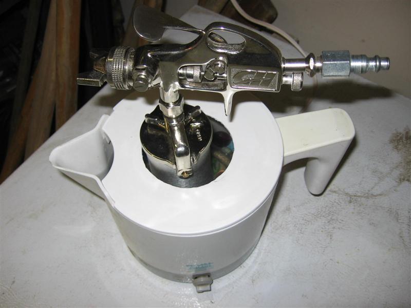

My glue pot doing double duty. 140 degree F lacquer sprays nicely.

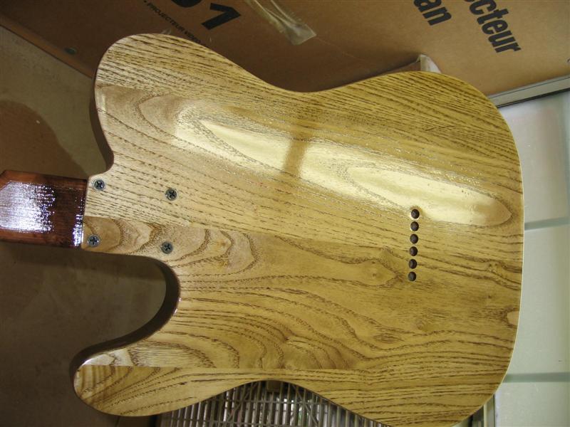

69 Tele Thinline Klone, someone gave me this body. I thought honoring the gift by completing the guitar would be good. I stained this will oil based stain. What a mistake. Fisheye/Crawling lacquer city. But I have it by the tail now.

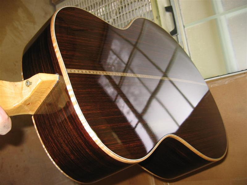

My son just graduated college, this is an OSJ for him. Check out the gloss before buffout. Only two more days. Can I make it before Christmas?
