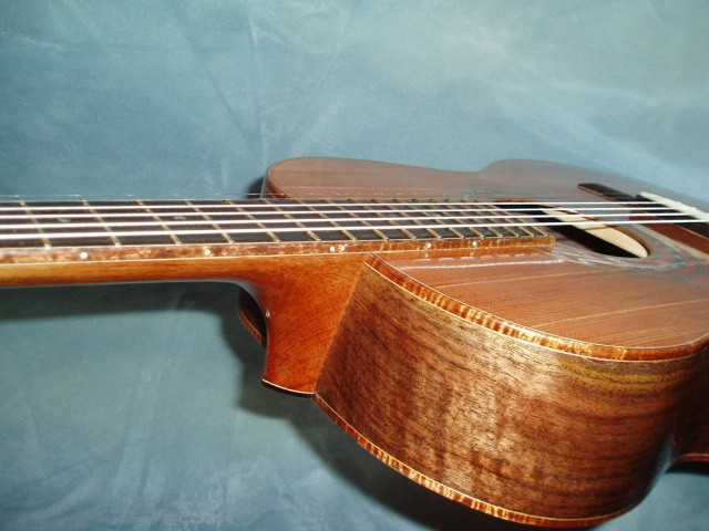

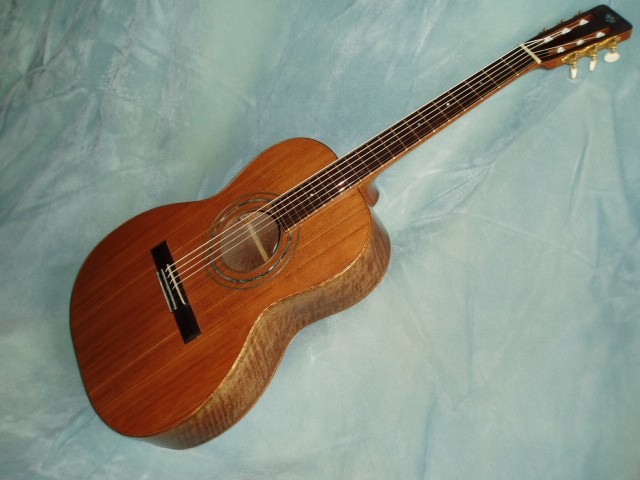

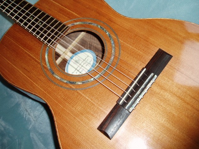

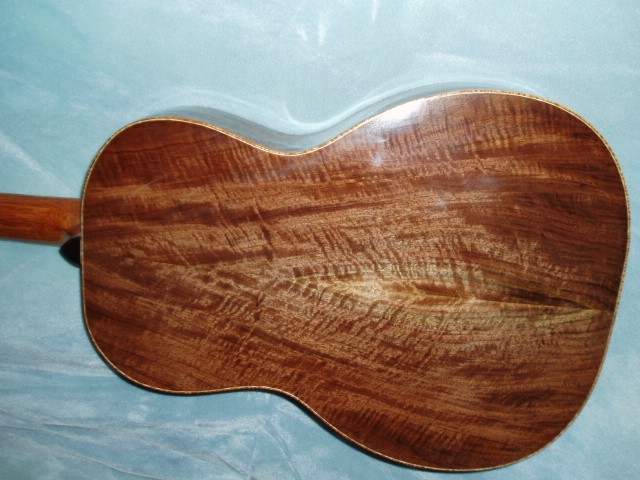

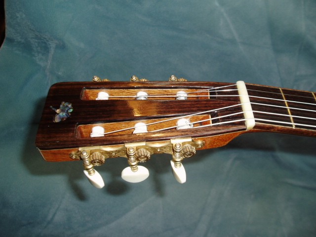

    Recently I mentioned building a Christmas gift for a family friend who is battling arthritis in her hands. The guitar needed to be easily held and played. The traditional Martin 000 shape sits in your lap perfectly and I braced it for either silk or nylon strings (gasp). I used a redwood top for responsiveness and a short scale for even softer strings (double gasp). The action is set as low as I could possibly get away with. The body is claro with Shanes koa bindings and Gotoh matte gold tuners.
   I know the purists are going to tear me apart for creating an oddball like this but remember it was built to answer a specific need. I will say it plays like butter on a summer afternoon.....
Enjoy!

Why would a purist have a problem with a nice guitar like that?

That's a gorgeous little guitar that's going to bring a lot of joy. I've said it before and I'll say it again - curly koa is my all time favourite binding, and the claro and redwood just work so well.

Sure is purty! I just love koa, its so warm...

What is the nut width?

She`s a Beauty.I`ve been thinking about something similar for my grandaughter.Did you attach the neck like a steel or classical?
