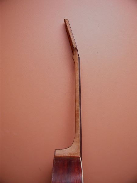

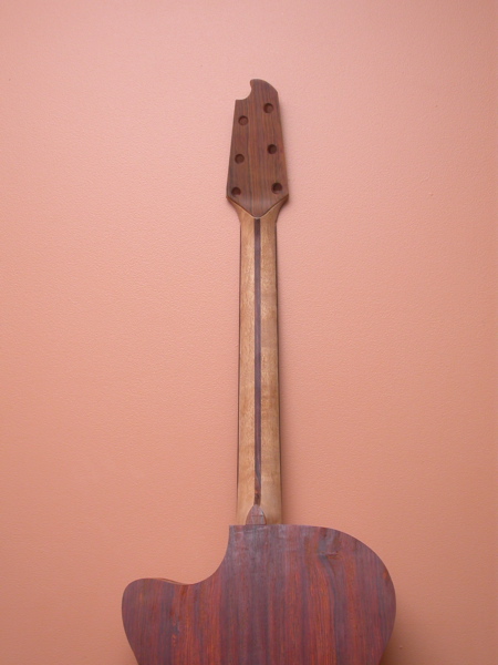

Hello all. I finished the neck carve on my latest and looking at it, I think I went too thin. Depth at the 1st fret is 0.760" and at the tenth fret it's 0.870". I was going for a V-shaped contour, but it just looks too thin to me. I'm hoping strength won't be an issue - the center strip is 1/4" wide cocobolo, but it's routed 3/8" deep for the truss rod, which is a two way from Allied. Fingerboard is Macassar ebony. Main neck wood is curly mahogany. Did I go too far?? Thanks!
Here's the back view:

Does your measurement include the fretboard?
No truss rod peeking through the backside?

Looks perfect to me. I shoot for 3/4 at the first and 7/8 at the 12th. Pretty much the same.
Of course, I'm short on experience.

Bruce: Yes and no. Fingerboard is on the thick side, as is my preference. The
truss rod is at least 1/8" from the surface of the back of the neck, so I have
some leeway there.

I agree with Mark, it looks a little thin. I shoot for about .020 under the numbers Mark posted but those are still much thicker than your numbers.
As a heads up, have you dry-fit your tuners yet? I think your high e is going to run into the valute and cause you problems. (Maybe the low E too for that matter.)

Paul - Yep, I think I goofed with the tuner holes, too. Too much shaping on
the volute. And to add to it all, I shattered a bird's eye maple neck blank on
the shaper yesterday. Maybe I need to take a break from building for
awhile...

Hey Pat. Seems a little thin but should be ok. The next one will be better. I
made the same goof with tuner holes on an octave mandolin and had to
intall mini's upside down.

Tommy - I checked the tuner hole with the Gotoh 510 tuner I'll be installing,
and I just made it without overlap. Whew!
