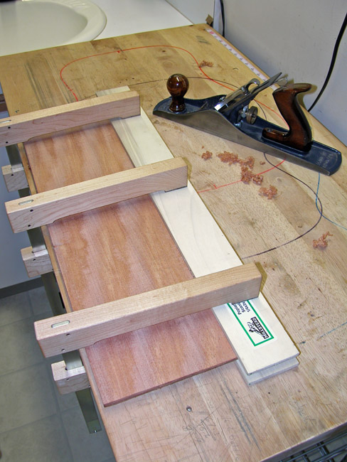

PostPosted: Sat Nov 24, 2007 5:20 am
Posts: 241
James, here's my set up. The clamps allow me to two hand the plane though Jose' held the top with his left hand and worked the plane with his right.

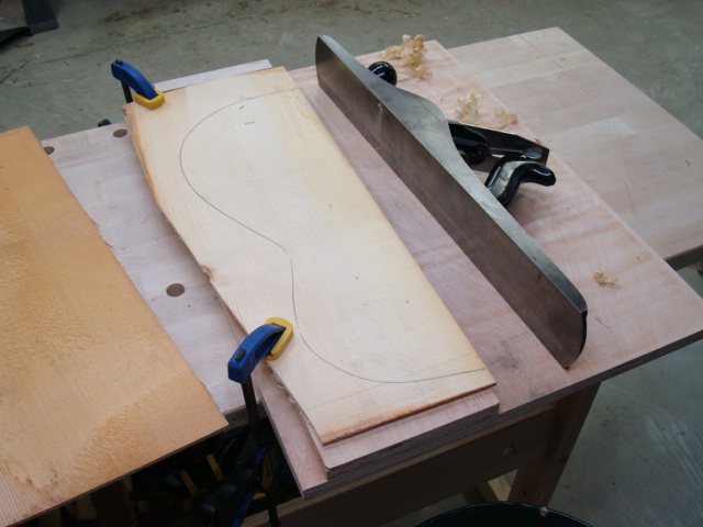

James buddy I used to use a 24" straight edge but after reading over and over again here that it was not necessary I nixed it.  So no more training wheels here.
The trick is to learn how to be very uniform in the pressure with the plane and to keep the sole flat on the edge at all times.
If you use a level with sand paper on it, which I have used too to touch up a joint on the high spots - be sure to use clean paper on the level or dedicate it to only tops or only backs.  Ever see a darker line in finished guitars here or on yours - if the joint was sanded with a level and dirty paper this is likely the cause.
