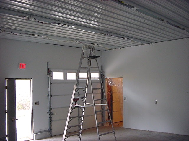

I just hung about 25 sheets of 10 and 12 foot 5/8 firestop in my finishing shop a month ago and let me tell you, that stuff is
H E A V Y ! The 26 foot steel ceiling liner was even heavier!!
It looks so pretty all white and shiney now though, worth the work!
