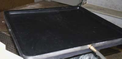

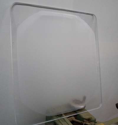

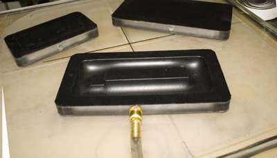

I was making vacuum bridge clamps and a two-piece brace clamping system for awhile back before I had the chance to advertise here. I also made a guitar holder similar to the LMI one for Shane, just the dish part (he made the mounting parts). I use in-house vacuum fixtures to hold down almost everything in the shop for machining, necks and bridges, mounted inlay, and even some aluminum parts.
If there are enough people interested in any specific part to justify a run, then I wouldn't mind doing some up. It's all about covering the setup time, I can match pricing on Asian made parts if I've got the quantity. I've done some really custom tooling, some of it using vacuum, for Mario. I was using the same type neoprene rubber sheet LMI sells for my stuff, from a local rubber supplier, and I can get that at a pretty low price compared to theirs.
Here are some pics of the bridge clamps, the airtight radius dishes (well, they're acrylic, so they're also water and warp proof and super-tough), and the vacuum lid:

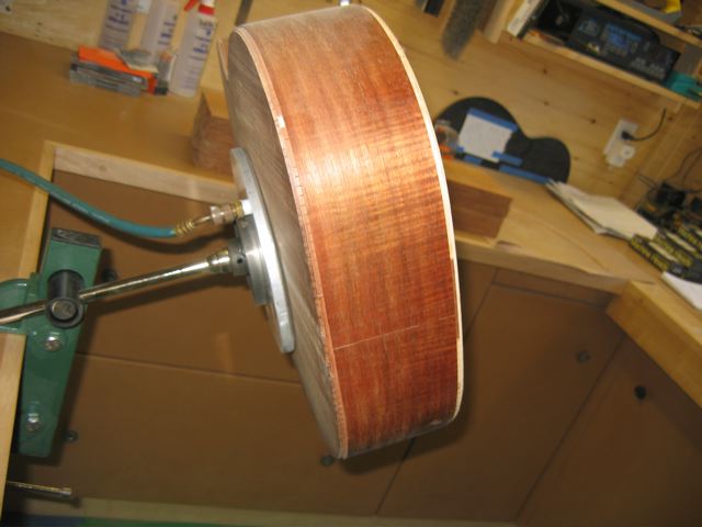

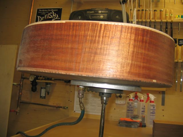

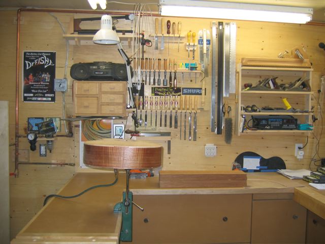

Bob (Garrish) and I have been thinking about marketing vacuum fixtures for a while now. There are a couple of issues to resolve, aside from Bob and I both being almost too busy. First, these things have a few parts to each of them which takes some time, time equals money. Next, the materials are not cheap. And lastly, in order to keep costs lower (I didn't say low because that does not exist in these things!) we need to "runs" of items to make the CNC set-up and programing cost effective. We have done some prototypes and are talking of some adjustments and, again, if there is interest we will move forward and get some of these things available.
Here is the guitar holder that we made, I have adapted a readily available clamp system to this that will bring the retail cost under the LMI price by 10% or so.
Oh ya, my vacuum set up is simply a refrigerator compressor. Cheap (read free from your local appliance repair place) and quiet!! The most expensive part are the $70 gauges but that includes the hoses.

[QUOTE=RickH]
[QUOTE=Bob Garrish]I was making vacuum bridge clamps.How would that work Bob?I checked out your Website. Cool stuff. Looks like fun too![/QUOTE]
If you check out the top picture in my post, that's the bridge clamp. You set it over your bridge and pull a vacuum and that black rubber is now pushing down with 14PSI on whatever I stuck under the clamp for that photo :)
