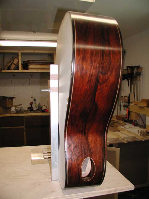

I built this jig to the OLF plans. My first and only neck that I cut using it had too much of an angle. I'm sure it is totally my fault, but I'm not sure how I messed up. Here is what I did.
I taped the bridge on the top at the appropriate location.    Next, I put the guitar body on the jig and adjusted it until the body touched at the bottom and on the bridge.
The angle measures at 4°. I'm thinking it should be about 1/2 of that. The top has a 25" radius, my bridge is 0.375" thick.
What am I doing wrong?
Thanks!

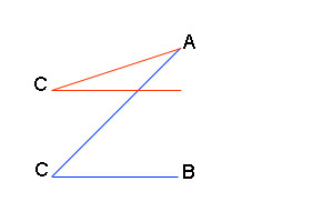

PostPosted: Wed Nov 21, 2007 6:48 pm
Posts: 4820
Hey Steve
Look at the graphic I made. Points A and B stay the same, but when I move the vertex (point C, where the lines intersect), do you see how the value of the angle changes? I'm not sure how Paul designed his jig to work, but whether the fretboard is on or off will change the point of the vertex, which changes the value of the angle. Same goes for whether or not the bridge is on or off. That will change the value of the angle by moving point A in this case. Try to find out what needs to be on or off for the way Paul intends the jig to measure angle.

Because the Aluminum bar rests on the body, it represents the bottom of the fingerboard plane. So, yes, you need to reduce the thickness of your hypothetical bridge by the thickness of your fingerboard. Then you'll have a good angle.
Did you build this from the OLF plans? If so you'll notice that there is a bolt going through the aluminum bar at the bridge location. It's there because you can't have the thickness of the bridge in that location. So reduce the thickness of the bridge by the fingerboard thickness and that's how much bolt you should have sticking out.

PostPosted: Thu Nov 22, 2007 1:58 am
I think this previously posted image shows the bolt?

[QUOTE=Pwoolson] Because the Aluminum bar rests on the body, it represents the bottom of the fingerboard plane. So, yes, you need to reduce the thickness of your hypothetical bridge by the thickness of your fingerboard. Then you'll have a good angle. [/QUOTE]My fingerboard is .250", my bridge is .375". What about frets and saddle?
[QUOTE=Pwoolson] Did you build this from the OLF plans? If so you'll notice that there is a bolt going through the aluminum bar at the bridge location. It's there because you can't have the thickness of the bridge in that location....... [/QUOTE] Yes, it is the OLF plan. This guitar is a baritone, and I build short scale along with more standard scales. I was thinking that it would be good not to add the bolt and holes in the bar but put the bridge (or appropriate spacer) in the proper place instead. Does that make sense?
