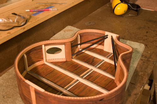

Here's an interior shot showing lots of what we do...not everything, but quite a bit...
PostPosted: Thu Nov 15, 2007 5:07 am
Rick,
That's really neat. I'll have to have a go with the cf capped backstrip sometime soon. Presumably you have to have the back in it's final lengthwise arch before you glue on the cf strip? And then put on the back braces with notches to bridge the back strip? I don't build in a sanded dish (as I don't do spherical surfaces) so would have to work out how to handle this.
