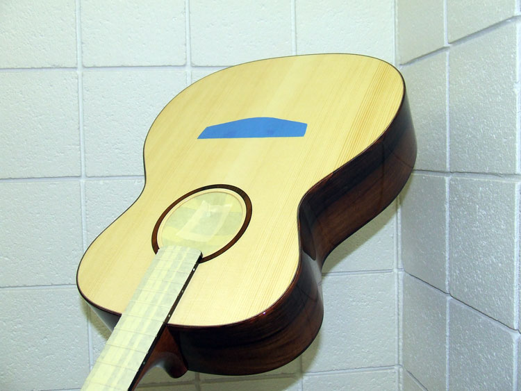

I've been following the book on finishing, scraping the finish and gluing on the bridge.  I think some of you, Hesh included, attach the bridge before finishing.  I'd like to give it a try.  Are there good reasons either way?  I will be using Colortone water-based spray lacquer.

Thanks Coach Tony - I do indeed mask where my bridge will go prior to finishing.  Cutting off the masking is very easy.

I finish (lacquer or French polish) the entire top and then position the bridge utilizing either bridge pins (steel string) or locating pins (classical) to establish it's location. I scribe and mask (the entire top) and then use a stripping agent (Stripeze, Zip Strip) applied with an artist brush and using a 1/2" chisel lightly scrape to remove the finish, followed with a light clean up sanding with a postage stamp sized bit of 100 paper.
This is totally undisruptive to the top under the bridge and provides a flawless finish to bridge juncture.

   I mask the area where the bridge and fingerboard will lay on the top,
spray and work the finish to completion and then remove the masking
material.
Finally, i lay the fingerboard and bridge in place, holding them securely
down and cut around their perimeters with a fresh x-acto blade.
    The remaining finish, which is typically between 1/32" to 1/16" wide is
then removed with a small chisel providing a full wood to wood contact
area under both.
    The masking material measures about .005" and provides a known
thickness to sand the finish to before buffing, too.
