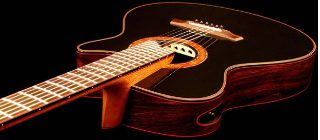

     I noticed on Charles Fox's Ergo there are hole in the braces right by the soundhole. These are viewable from the top easily. I was wondering about that too! Probably structural!
     I would have to hear the difference to believe it also!
