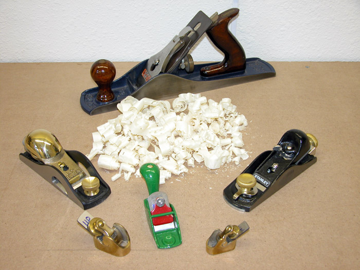

Peter you can't go wrong with LN other then perhaps selecting the wrong plane for the work that we do in guitar building.  Both choices are excellent.
Add a couple of finger planes and a #5 plane for joining plates and you will be all set.
Here is a pic of what I use.  The green one from LMI is nice but I have my eye on the LN MM plane too.
I have one of Chris's hand made block planes too that Todd is talking about and although I have not sharpened the blade for it yet and used it I am sure that it will be an excellent plane.

Hesh, that pile of shavings must have been killing you!?! How long after the
picture being taken did it last?
On a serious note...the Ibex finger planes are super useful for shaving
braces and numerous other functions.
Jamie

Jamie those shaving are from a genuine Adirondack billet that Wayne Henderson's dog...... well you know......  I was going to write a book titled "Clapton's Guitar Luthier's Dog's Favorite Tree...."  Do you think it would sell?
The most embarrassing part of the picture to me is that I had to label which side of my plane blades is "up" and now that I know which side is up the Sharpie won't come off...........

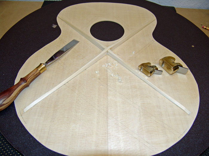

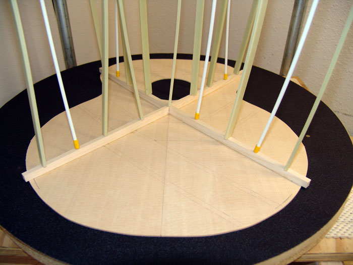

Peter I probably use my finger planes more than my chisels.  I use them for taking the excess material off the sides of the braces to get a triangular profile.  I also use them for taking feathered braces down to near nothing and finish up with a sharp chisel.
They are great for scalloping too although what I am working on this afternoon will not have scalloped braces.  Take a peek.

Peter - good question!  Although all builders will develop their own methods I use the green plane, much like the LN MM plane, to initially taper the X-brace legs.  For people who scallop their braces this may only be done on the front legs.
You can see from the picture below and then looking at the previously posted picture that most of the original brace material has been removed.  In my style of workmanship I prefer to use planes for the major shaping and stock removal.
All of the X-brace legs were tapered with the green plane.  The low angle block plane could be where I used my LN block plane to reduce the height of the X- brace intersection.  As I was tapping this top I felt like I needed to plane the intersection down some prior to adding the cap.
Both planes, the block and MM plane could/would be used also to initially shape your brace stock to uniform, desired shapes and dimensions.  I do this in a thickness sander now but did use the planes many times prior for shaping brace stock.
Additionally the MM plane can be used to profile a side for radiused sides and backs.
The uses are endless and again dependent on a particular builders building style, what tools they prefer to use, and what they have as well.
