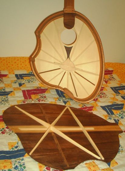

But, if you're going to use suspended bracing, why not go all the way and allow the shear force of the strings to utilize the structural bracing to its best advantage. (Plus, have some fun coming up with a new bracing scheme.)

[QUOTE=Bruce Dickey]Dennis, wow, what an innovative bracing scheme. Did it work? Bridge too, wow.[/QUOTE]
Thanks, Bruce. I really thought the whole system was innovative, and only learned of the Ned Steinberger/Steve Grimes "stress-free bridge" patent, as well as the *Tilton Improvement* guitar after I designed and built this one. Unless someone knows about a guitar with a bracing pattern similar to my "Pivoting Radial" design, maybe there was one innovative idea in my guitar after all.
It wasn't attempted as a gimmick, or just to be different; it was my first attempt at eliminating the X-brace, handling the string forces other than ending at the bridge, and trying to find a bracing pattern that permits the top to move in a more *natural* way.
"Did it work?"
Well, that depends on who you talk to. According to William Cumpiano, this un-guitar (actually, he called it a "musical sculpture" and "the thing") has no redeeming qualities whatsoever, lacks bass, and its overall volume and timbre are best described with the punchline to the old musician's joke: "...far far away." Every other player and luthier that has played and examined it seem to feel otherwise. In my opinion, it was a huge success as a prototype, and is quite playable. To my ear (echoed by all but one), the bass and mid bass volume, definition, and sustain are remarkable. From the mids to trebles, I think it is just average, but not lacking. Overall, very good volume, remarkable sustain, pleasant timbre. Not among the greatest guitars, but I feel it is a very successful self-engineered prototype, and not a bad first attempt at a guitar. Hopefully sometime we'll cross paths, and you can play it (and/or some of its successors) and you can tell me it you think it works.

[QUOTE=DennisLeahy] I really thought the whole system was innovative, and only learned of the Ned Steinberger/Steve Grimes "stress-free bridge" patent, as well as the *Tilton Improvement* guitar after I designed and built this one. Unless someone knows about a guitar with a bracing pattern similar to my "Pivoting Radial" design, maybe there was one innovative idea in my guitar after all.

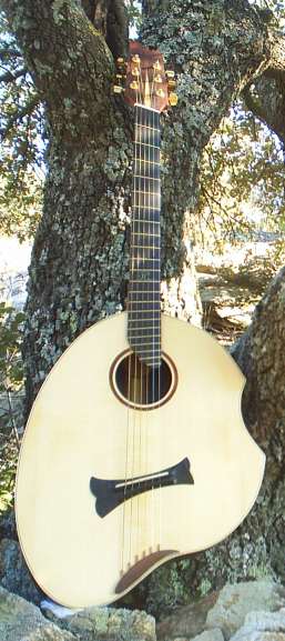

There is this interesting guitar built recently by the French builder Pierre Lamour and posted on the MIMF:
It uses a similar tailpiece and tunnel bridge and the bracing is similar'ish. He described it to me as a "kasha" type bracing. He loved the sound it produced.
Interesting stuff.

These appear to me to some type of Kasha derivative, Steve Klien's bracing I believe is similar.

Sacrebleu! Pepe Le Peu! Le French builder Pierre Lamour has stolen my idea! (Did he steal it first or second?)
Here's a Klein take on Kasha bracing:
I have never had the chance to examine one, or even to see the bracing from various angles, but is it true that there are struts that sort of tie the bridge plate to the sides? If so, that seems counterintuitive to me (but maybe was in defense of the torque from stopping the strings at the bridge?)
I used a single transverse brace beneath the saddle, flanked by a pair of half canoe shaped bridge plates, beneath a skinny canoe shaped bridge. I wanted the bridge to be able to rock fore and aft ("long dipole"?) easily. The radial braces were meant to quickly spread the vibrations across the top. I did see and was influenced by A J Lucas' radial design before I built mine.
Mr. Lamour seems to have adopted the quasi-hourglass shaped bridge plate (possibly laminated?) that Kasha used, which would seem to inhibit some of the pivoting/rocking motion, but does look kinda sorta "pivoting radial." I just took a minute to peruse Mr. Lamour's site - sort of Fred Carlson meets Linda Manzer - and I saw and heard some very impressive creations. I don't think he needs to steal from anyone.

I think you should keep experimenting with it, if that's where your hearts at. Try not to be too discouraged with Mr. Cumpiano's comments, unless of course you were trying for a standard guitar.
