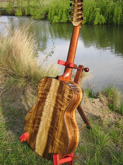

I bent this at 2.5 mm. ( .1 " ) with no problems

/\ Wow, Craig, that's a total BEAUTY!! My jaw is on the floor here...
Where'dya get that wood from? (I mean supplier)

Thanks Sam . It came from L.M.I.
I bought two sets actually . The other is very similar.Everything I have received from them has been of the highest quality.
Many many thanks to L.M.I. They ROCK !
