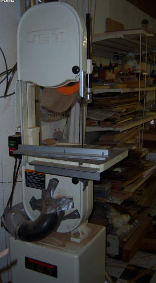

Well in this thread I can proudly acknowledge that I have a Jet 12"
It's fine and I have enjoyed using the saw.  It was never meant to resaw so if that is what you want to do this is not the machine that you want.
I had and really still have space limitations but I wanted something more powerful than my Ryobi 9" and I also needed it to be easy to push around on wheels.
The toughest duty that I have ever done with this saw is cut up 3" square Adi billets and it does that fine.  But I doubt that it would do any more but that's OK for me.
I have had this saw for two years, gone through 3 blades, never had a lick of problems nor sensed any vibration.  I also like the way I can open the top or bottom access covers and use the vac in there to keep it clean inside and out.

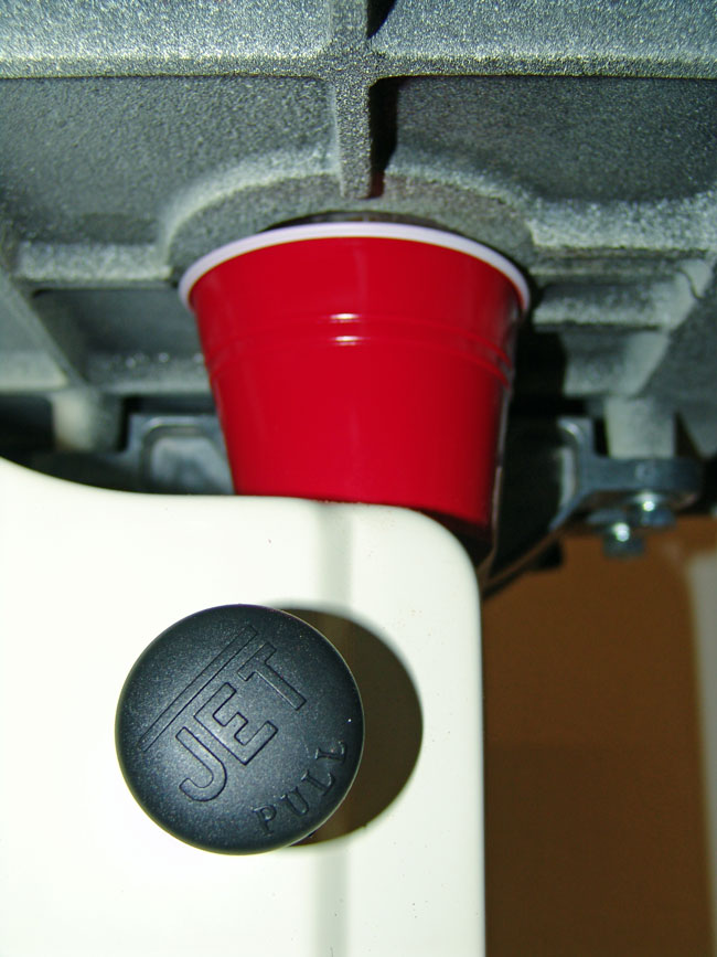

The dust collection left something to be desired when I bought it but was easy to mod with a plastic cup that then connected the lower half of the machine to the top of the table.
