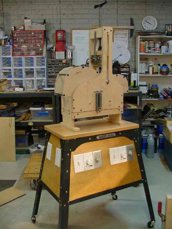

PostPosted: Fri Nov 16, 2007 2:48 pm
You can buy a 1000 Watt 110V. Commercial Dimmer at your local home improv store. The standard ones are just 660 Watts and under-rated.
I wired my single blanket up with a simple male plug. I wired my 1000 Watt dimmer to a duplex receptacle. That allows me to power up full starting out, then power back to about 70 to 80 percent for the balance of the time.
I started like Lance, just plug and unplug, but graduated to a dimmer and found it convenient. Nothing like pulling out a nice set of sides and witnessing you've turned it to toast, hence, control is good.
Also, bend in a breeze-free environment. Ceiling fans and air conditioners are banned during bends at my shop! And good luck bending....
PostPosted: Fri Nov 16, 2007 3:02 pm
Brock posted his double bending blanket setup a while back. Here he has a timer, powering up a dimmer, wired to a duplex receptacle, one set for each blanket.
Pretty cool, and the timer gives you that little comfort that you'll not burn your shop down, or house, if you get called away during bending.
