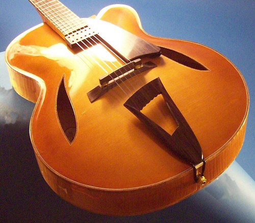

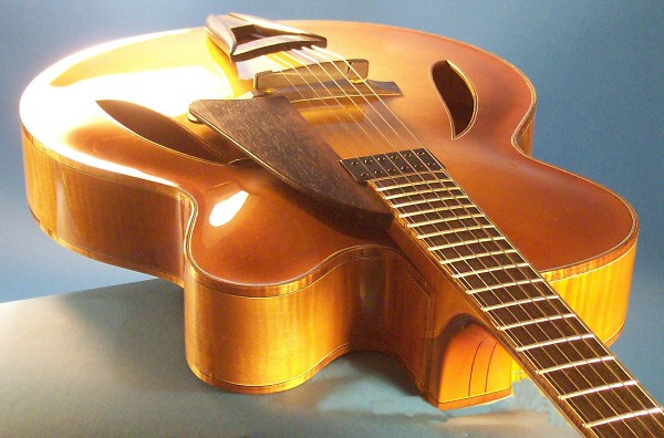

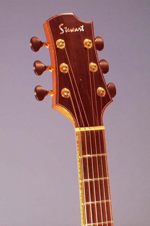

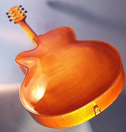

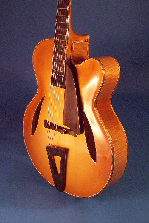

I finally finished #4 this weekend and wanted to share some pics.
Materials are Englemann with Euro Maple B&S and maple neck. Macassar ebony fingerboard, headpiece & fittings. Curly koa bindings & Gotoh 510's from Shane. The finish is Target Ultima. It's my first attempt at colour, a light single colour sunburst to bring out the koa & I was happy with the result (not as yellow as it appears). The Ribbecke/Manzer "duet" was also an influence. The pickup is Kent Armstrong's handwound PAF, with a "hidden" volume thumbwheel under the aft corner of the pickguard.
It's basically a 17" Benedetto plan, but with the non-standard f-holes give it a bit of a "D'Aquisto" look, so this time I reworked the bridge base and tailpiece to try to compliment that look.
Anyway, thanks for taking the time
Dave
Milton, ON
