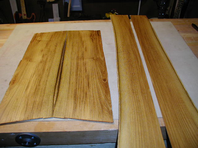

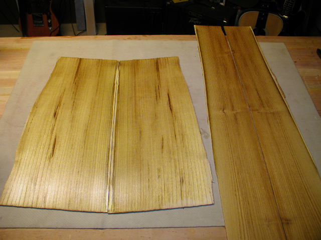

PostPosted: Fri Nov 09, 2007 10:41 am
Posts: 2186
Location: Newark, DE
First name: Jim
Last Name: Kirby
Here are pics of the two sets I have. I'll have to retract the butt-ugly comment. It has a nice color under mineral spirits - reminiscent of myrtle.
The smaller of these two sets is longing to be a flamenco - it's going to be too thin to be anything else before I get all the saw marks out    Ukelele?
