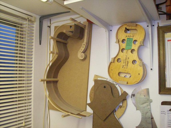

PostPosted: Thu Nov 08, 2007 9:20 am
Posts: 1383
Bob........this has worked well for me.
Just 8" dowels in MDF. Good for wood bindings too & keeps things safe from harm. You can induce a bit of overbend in the dowel placements
Dave
Milton, ON

I wish I had thought of that!!!!! Thanks Dave Stewart!
By the way, is that a v***a in the process of construction??
Steve Walden
Aspiring Builder,
Bartlesville, OK
PostPosted: Thu Nov 08, 2007 11:21 am
Posts: 1383
Yeah, it's a definite KISS approach, kind of a V8 "smack on the head" idea.
The violin rims on form is a Guarnerius copy ("del Gesu" 1734). (With violins, you HHG the corner blocks to the form, shape & inlet the side pieces, install solid linings top & bottom, then break the blocks free & twist/persuade the form out of the assembly!)
Dave
Milton, ON

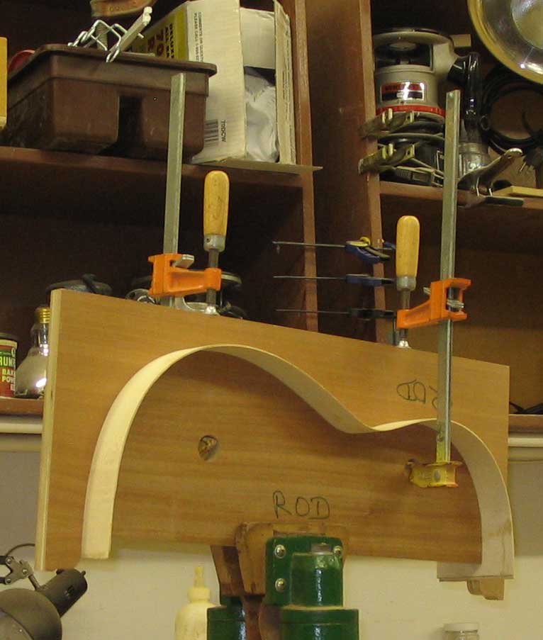

PostPosted: Fri Nov 09, 2007 3:06 am
Joined: Fri Nov 02, 2007 10:17 am
Posts: 14
Now I see why the message occasionly follows the image in a separate post.
Most of my sides are three- and five-ply laminations, and the glue is a water-based two-part, so I allow the glueups to condition (dry out) for a week before shipping. The single sheet of 3/4 ply exposes maximum surface area of BOTH SIDES, which is critical, and I consider this a very important factor in the storage of solid lumber, as well.  I restrain them like this because the highly figured show ply on the outside face wants to go crazy and take the rest of the construction with it; after a week, no problem, excellent stability.
The side showh is a two-ply, no crossply, maple for a classical builder.  I was afraid that two laminations (grain same direction) would have a tendency to curl across the grain, but now I believe that equal drying area exposed on both sides minimized this.
Got a lot of sides to store? Don't invest in clamps, use big rubber bands.  Put little feet on the bottom plate, and store sides all over your house.
