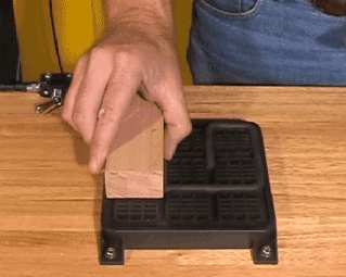

Anyway I was at a friend of mines cabinet shop the other night and he had these V-clamp all over his shop
The work using your compressed air through a venture port on the clamp and a rubber gasket. My friend loves them. He gave me on to play with. I got back to my shop hooked it up and tried it out as a holder while routing channels for binding with my luthierstool.com binding jig. Man this is perfect. I tried it for several tasks. It worked like a charm, so I ordered 2 clamps and2 on-off valves You can get the clamps single sided or double sides and tall gaskets for radius parts, but the standard gasket works fine with 15' radius backs. They hold good and tight in any position horz, vert, or upside down. The need 80psi-100psi air supply at 2cfm to work continiously

How loud are they?
Steve Walden
Aspiring Builder,
Bartlesville, OK
PostPosted: Thu Nov 15, 2007 9:46 am
Not that bad. The venture does make a liight whistle but it is not irritating or really load much less db than the router
PostPosted: Thu Nov 15, 2007 9:57 am
To classify the produce a fairly light whistle not loud at all. Louder when not sealed than they are under loading. Running a ROS or laminate trimmer you would never here it at all, least till you turned the trimmer or sander off.

I found a link to the site: http://www.vac-clamp.com/
It looks like an extra $12 for the double sided kit. Am I correct in
thinking you wouldn't need to mount the double sided in order to use it?

just checked out the website...i guess the venturi is located right in the jig?
If you want to generate vacuum using compressed air, just do a search for "vacuum generator". You should be able to find some similar venturi systems which you could route to your own jig.
http://www.PeakeGuitars.com
PostPosted: Thu Nov 15, 2007 2:50 pm
yep
PostPosted: Thu Nov 15, 2007 3:12 pm
With out a doubt you can find tons of venture vacuum generators. We have them here the plant that lift 3000 lbs sheets of plate using 3-6" diaphrams. Most systems have the switch and venture in on single unit that can be plumbed to one or several fixtures. But not one that I could find was less for the the venture valve than this hole system is with two fixtures and a on off switch valve.
That said I am still searching. Since I have plenty of air volume available I may think about working a bridge clamping system using a venture supplied vacuum system. However the prices I find it is about a wash out compaired to a dedicated vacuum pump.
I just liked these for the ease of being able to use any where ever I have air supply and that would be in all 4 rooms of my shop and at a pretty reasonable price.

I have a small vac pump and a venturi. I find the venturi pulls a better vacuum, much higher CFM at full vac, but it uses a lot of air and is noisier so I use the electric pump when I can get away with it.
If you don't have a pretty hefty compressor sitting around and don't need enough suck to stop a guitar neck from flying off your CNC, then the electric pumps are a great deal.
I do find it funny how expensive the venturis are considering how little stuff there is inside there, though...

Would these clamps work with a vac pump instead of using the venturi type? My vacuum pumps make far less noise than my compressor does.

Looks like those guys only make clamps with built-in Venturis. There are a bunch of companies making vacuum clamps for general use (Google). If you want to roll your own (ie: drill a hole, apply weatherstripping, profit!) then check out http://www.joewoodworker.com/veneering/vacuumclamping.htm

You would have to chisel out the built in venture as it is built into the fixture not using an external generator
