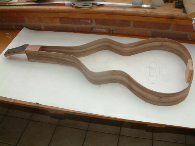

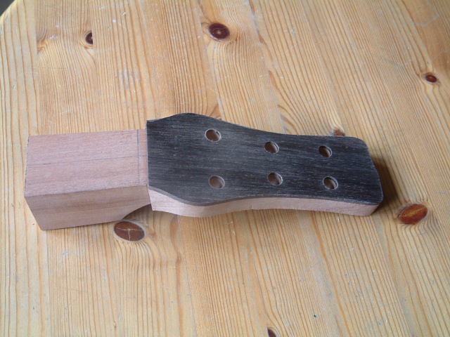

Here are pictures of the head-block I made:
[QUOTE]
- How are the sides rabbeted into the head block?
From the pictures you can see that there is a rebate for the sides in the head-block so that when they are glued they butt onto the headstock and the headstock is carved to meet them. When gkued up it looks like this:
[QUOTE]
- Is the top or back rabbeted into the head block?
No'ish . The top glues on to the top of the head-block, but the headstock veneer on the downslope forms a sort of rebate (see above picture). The back is glued on as well and then blended into the curve of the headstock bottom.
[QUOTE]
- Is the head block full depth, and how far into the body does the block extend?
The part of the head-block that is inside the hollow neck is full depth in terms of it having the top sides and back glued into it. I didn't take exact measurements but it goes back around 2-3" into the hollow neck.

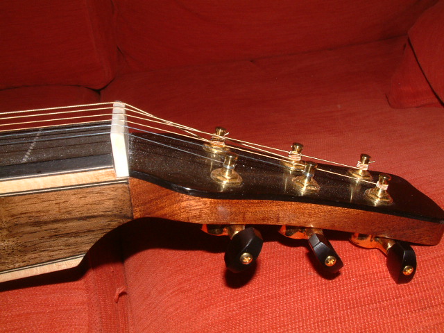

I did mine on the top. You could do it on the headplaye I suppose but given the height of the nit I think it would be stronger on the top. Here's a picture of it finished:

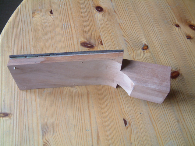

No. I used a lattice of carbon fibre in the hollow neck before the top was glued on. Plus as the top under the fretboard wasn't long enough I put a spruce brace in where the top stopped and an extra top piece was glued on to reach the headstock:

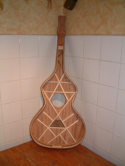

When planning the top braces, it's good to keep in mind the extra high bridge / saddle. That's a lot of torque on the top & needs stiff bracing. A friend of mine has owned several original Weissenbornes & he told me they tend to be weak in the bridge area & above the soundhole. According to him, distortion (& failures)in the top were quite common. The Original Weiss braces were about 3/8" square (IIRC). I used a modified X brace pattern with the X braces 5/16" X 3/4" (before carving). Most of the other braces are 1/4" X 5/8", except for two beefy ladder braces above the soundhole.
When deciding on string height, I borrowed a capo from my buddy & made the strings just high enough to accommodate it. My strings ended up lower than Dave's. (I wanted to keep the string height as low as possible to minimize the torque on the top.)
This instrument is 18 months old now & there is no distortion in the top so far.

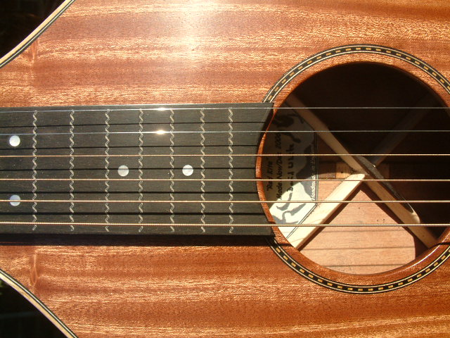

On the first one I used some rope purfling I had spare:
On Martha's I used bwbwb purfling I had spare. I set up a jig for my laminate trimmer and found a router bit that worked in each case. On the next one I'm doing (a double neck) I will either use the rope purfling or some birdsfoot purfling.

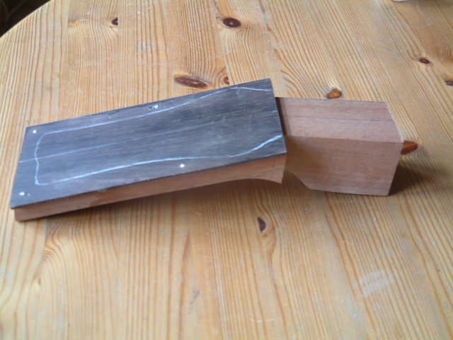

On the fretboard I actually took the opposite view and thought of it as a brace to help stiffen the hollow neck/soundhole area. I think it was around 8mm thick.

I just measured the depth of the fingerboard and it is around 7mm. String height above the top at the bridge is 5/8" and it definitely sounds "sweet"

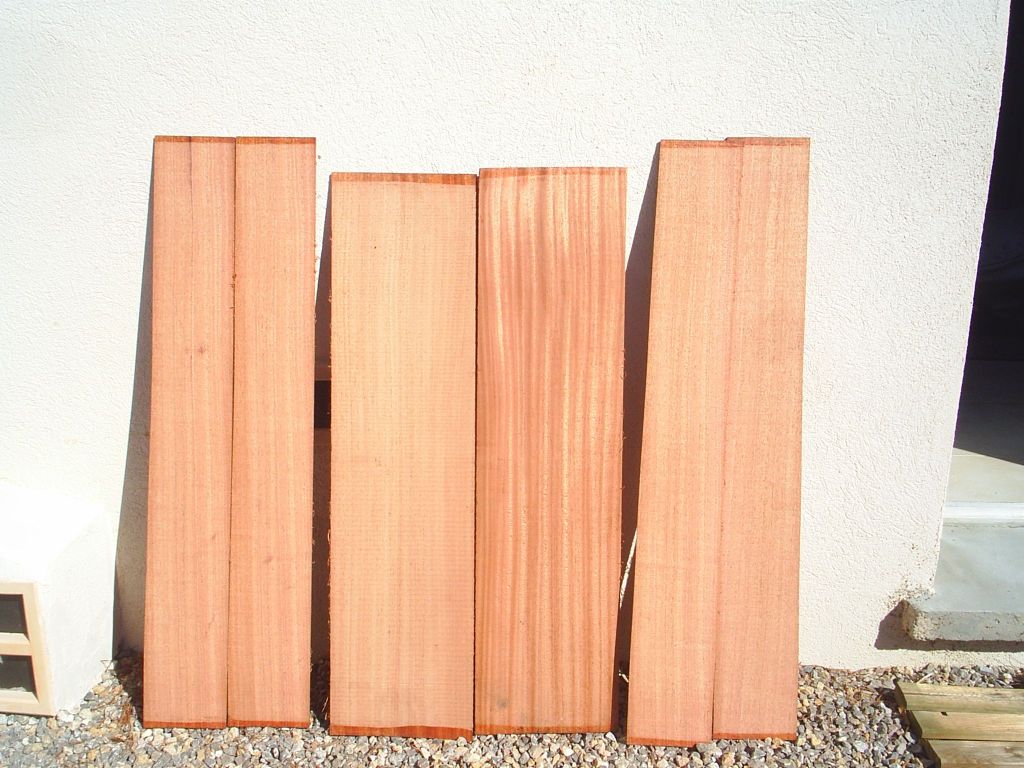

I've just today got the African mahogany that will be the double neck - plain and simple but has a nice tap tone:
