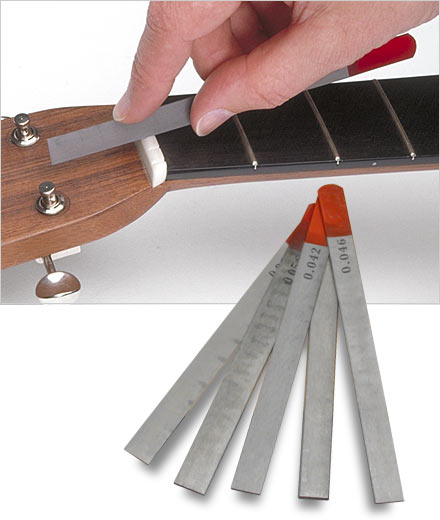

Peter I like these from Stew-Mac and I have tried others too but these seem to help me to easily keep the angle at around 7.5 degrees.

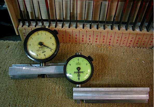

The double edge files are alright, like the StewMac or Ibanez ones. My
favorite however would still be the joint edge files like those pictured above.
I prefer the cut on the Grobet files over the StewMac ones, but I still have a
number of each to fill out my set. Eventually I assembled a set that I'm
satisfied with consisting of Grobet, StewMac, and some unknown import
files. including all the files I ended up not including in the set, it ended up
costing several hundred, but I'm very happy with it now. Of course not to
trust sizes as labeled, I made sure to make cuts and check with feeler
gauges to relabel each one. Here's the set in the back of this photo.
