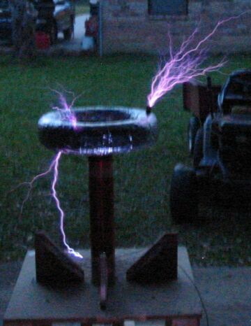

The giant Tesla coil was in my plans for a home security system, but I ran in
to problems with city codes. They're so strict around here.....
Just try and steal my lawnmower. I dare ya.
