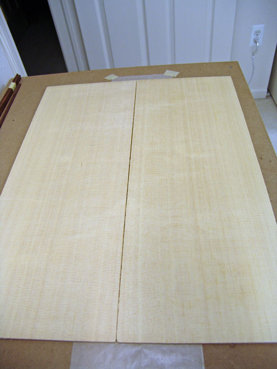

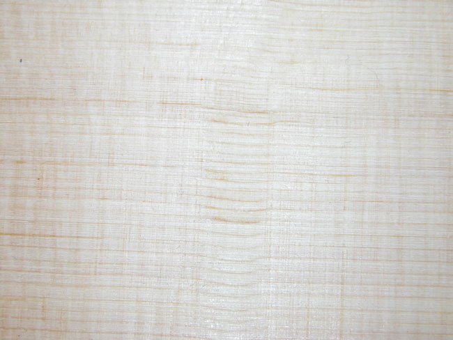

I need some advice guys.  This is the first time that I have worked with bear claw and I am not sure what I am seeing here.
The top has only been thicknessed to .145 which is my preferred joining thickness.  My photos are not good here because what I see with my eyes is a bit more profound then what the pics show even though I used editing software to try to bring out the features of this top.
Frankly I have never seen bear claw before not under finish and what I see here looks like some run out to me.  And, it all depends on the angle that you look at it too, at some angles I see nothing at all, and at other angles I see darker spots, random patterns, but the patterns are not symmetrical to both sides of the top.
This top is a nice top, it rings well and is stiff in both directions.  But I also see wavy grain in places and I am concerned about my own ignorance here.
Would you please take a look and let me know if this looks like bear claw or excessive runout?
Many thanks!
The blue is not on the wood it is a reflection of a band saw.
Thanks in advance for your help!
PostPosted: Thu Nov 08, 2007 12:46 pm
Yeah, hard to see it. Unfortunately, it isn't always as symmetrical as we would like it to be.
PostPosted: Thu Nov 08, 2007 1:28 pm
You should be able to see the runout from the side if it has any, with the two pieces of wood looking different colors.
I have only made one guitar using bearclaw, and it was lightly clawed. From the pictures you have posted, it looks normal to me. A side shot would tell the tale if it is runout.

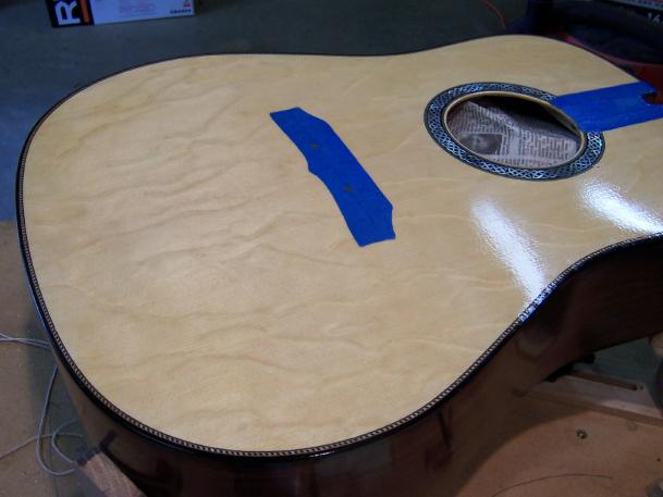

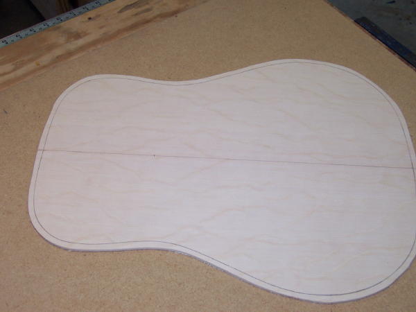

Hesh, here's what my last guitar top looked like before finish:
And here it is during finishing. Photography doesn't do it justice.
PostPosted: Thu Nov 08, 2007 3:07 pm
Posts: 13707
Beautiful Ron and that is the look that I wanted.
So you can see it without finish which tells me a lot about my top.  I think it's time to switch tops.
thanks buddy.
PostPosted: Thu Nov 08, 2007 3:12 pm
Yup, This came from Steve at Colonial, and I picked out two more just like it this summer when I visited him. Very high quality!!

Hesh, I think you are torturing yourself here.
Bearclaw can come in different degrees or amount of figure. Your top looks like bearclaw to me, just one with a mild case. I think it is a beautiful top!
You said it was stiff, rings well, so if you are still nervous about it, then send it to me. I'll use that wood proudly. I'd use Ron's top proudly too, but it looks a bit more committed than does yours. I love bearclaw, and really some of the best sounding guitars I've built have used this top wood.
No kidding, write me down as a fan...
PostPosted: Thu Nov 08, 2007 3:35 pm
I agree with Steve, Hesh. That top has mild bearclaw at best.
There sure appears to be a lot of nice medulary rays there, which shows how well the top is quartered.
Nice top.

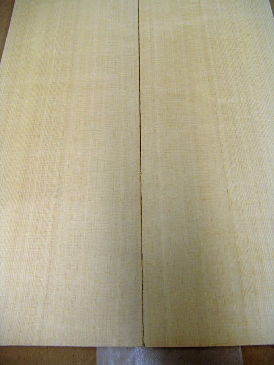

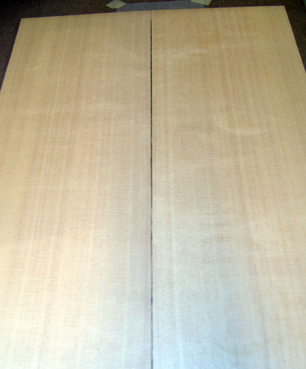

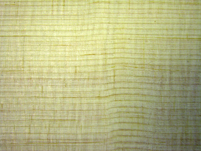

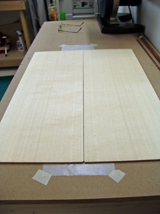

Many thanks folks but I think that I did a lousy job of providing you guys with accurate pics.  Now that I have some daylight here take a look at these pics and please let me know if this is problematic?
Maybe it's me - there is a dirty look to this top that bothers me.....
Many thanks.
PostPosted: Fri Nov 09, 2007 2:16 am
Bearclaw is localized run out.
But I wouldn't slow down for a second. Bearclaw tops can be as good as any other.

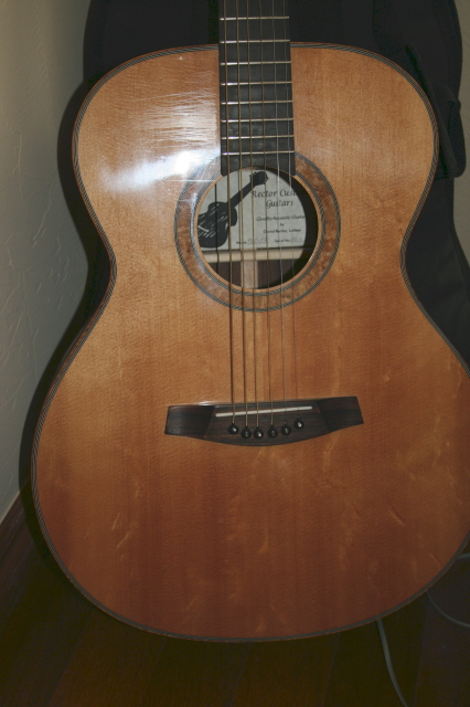

Hesh, I've built a couple of OM sized guitars with bearclaw and they are some of my favorites. Here's a pic of one I built several years ago that some fool carved up the top with a pick.

PostPosted: Fri Nov 09, 2007 5:49 am

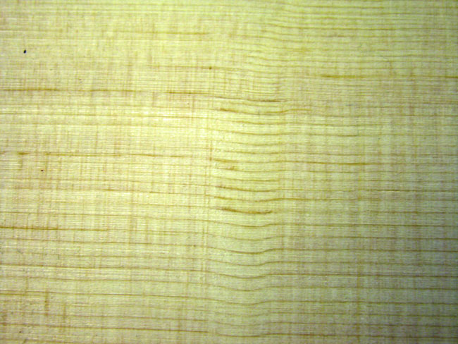

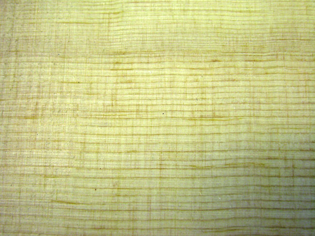

Posts: 2692
Bearclaw is NOT runout. It is deviation in the path of the ring of the annular ring of latewood that defines "grain lines." If you were looking at the end grain of a log with bearclaw, you would see the rings zig-zagging in and out from the center of the tree as they go around the circle. Typically the variation from perfectly circular is on the order of a half millimeter or so, but it is a sharp change out and back, over a distance around the circle of a couple of millimeters. [Sorry, I don't know how to use those graphics programs or I'd draw it] When sawn on the quarter, these variations show as bearclaw--local sideways movements of the latewood lines.
Your top may have a little weak bearclaw; it may also have some localized areas of runout.
