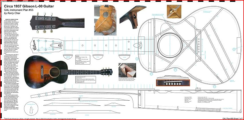

My good buddy Dave Anderson let me know this morning that GAL is now offering a 1937 L-OO plan!  I immediately ordered two, one for my wall in my clean room, er...... shop, and one to perhaps build from.
Many thanks Dave!!!!

You are very welcome Hesh.
That sure is a nice looking plan isn't it!

It sure is Dave.
On looks alone a 1937 Gibson sunbursted L-OO is my favorite guitar of all time.  I love em!!!!
Thanks for finding this plan Dave!

They are nice plans.
I met Kerry Char, and he looked my L-00 copy over, I didn't know he had a special interest in them. The plans that I drew for myself from a great L-00 that was in my shop had one tone bar, surely an anomalie. I must admit that I did overlook the fact that the X was a butt joint. As he says, most have missed it because it lives under linen. Surely this has some to do with the "loose" flavor of a good L-00.

PostPosted: Fri Nov 09, 2007 3:52 am
Does this set of plans have dimensions on it? I can't see them in the pic. Or maybe it is drawn to scale and you can just measure directly off the plans?

PostPosted: Fri Nov 09, 2007 5:35 am
I noticed the same thing as Dave. No dimensions makes for a very flexible build!

[QUOTE=Dave Rector]Does this set of plans have dimensions on it? I can't see them in the pic. Or maybe it is drawn to scale and you can just measure directly off the plans?
Thanks for posting this Hesh, this is currently my favorite guitar and the next one I will build. I think it's gonna be some of Uncle Bob's Cuban Mahogany with an adi top I got from Steve.[/QUOTE]
Dave buddy I don't know if it has dimensions - I hope so because measuring from paper is not a good idea since it shrinks and expands.  I'll let you know when I receive the plan.  I like that parts are in color.
PostPosted: Fri Nov 09, 2007 12:41 pm
If it is like the other GAL plans, it probably has some dimensions in the text on the page.  Otherwise, that is what the inch blocks at the top of the page are.  Supposedly, you can measure those and determine if the plan has shrunk or expanded, and by what percentage.
