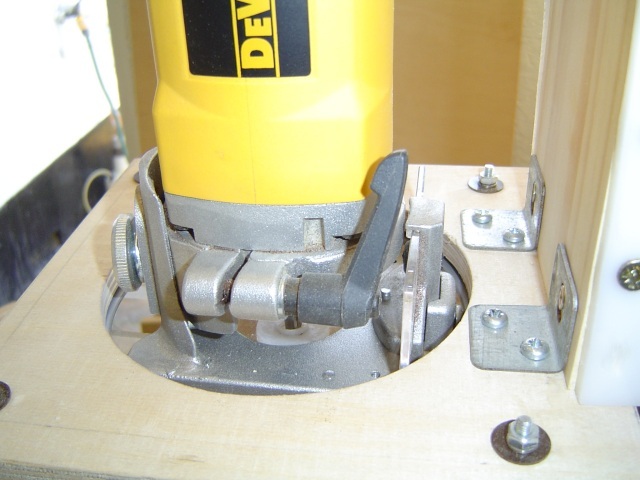

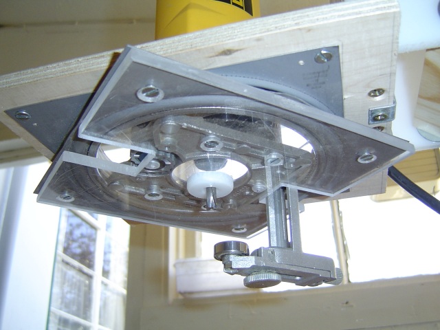

PostPosted: Wed Oct 31, 2007 2:24 am
Dave's modification, which I love as it enables me to use a downcut bit and a trimmer with a guide wheel that is infinitely adjustable, can be found on his website.
Dave's modification
Here is my interpretaion (copy) of it.
I made my own jig using the information on Don's site, mine though is unboltable into its three main sections for easier storage when not in use.
The weekend I spent making it is probably the most productive weekend in my buiding career. If you buy or make one you won't regret it.
