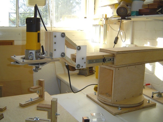

Jammy I use and like the DeWalt DW670 trimmer, I bought mine through Maxtool over here on line, but it is a US one, 110V, and was much cheaper than buying the same tool in the UK. All my hand power tools are 110V and run off a site transformer.
It does everything I want, and I especially like the solid construction, and of course the bearing guide.

Colin I like mine as well. Plenty of power. The only thing I don't like about it is the aluminum sleve and base gets hotter than a pistol while in operation. Does yours?

No, mine gets a bit warm but not too bad. I guess you've got a tight bearing, possibly no bad thing. Mine does only run in short bursts though.

Should have read: "I only run mine in short bursts" the trimmer runs faultlessly!
