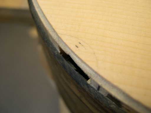

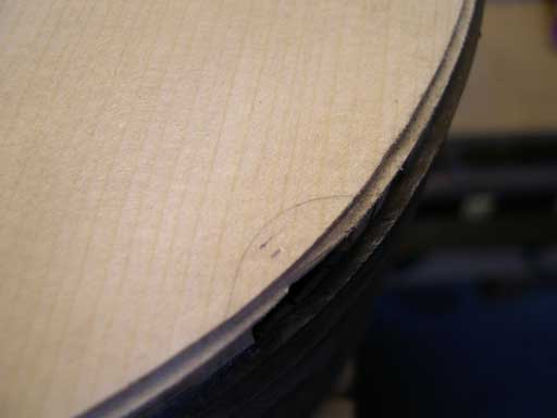

I was routing the binding channels for the Zircote guitar, had already done the back, was slowly making my way around the top when BAM!!!!
A piece of kerfing popped and the router bit made this nice little dime size dig in my top. After saying a bunch of not so nice words I found a cutoff from the top and made a little patch and "Attempted" to fix it, here is the result

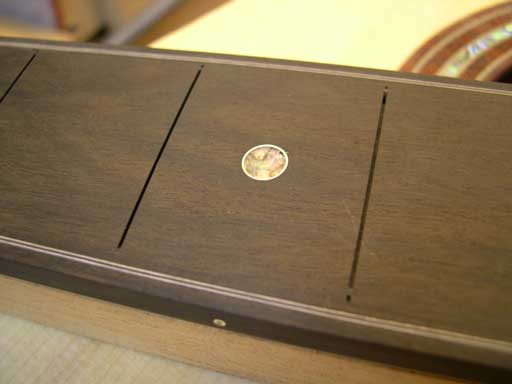

Outside of that I found that 1/16" brass tubing works pretty good for side dots:

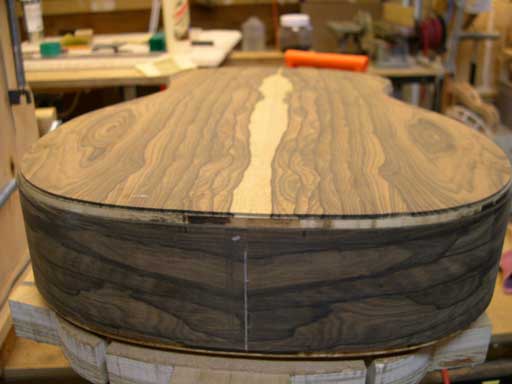

What hurts the most is that Bobs wood for this is just killer:

How about a sunburst finish on the top?

Well nobody wanted to listen to me in the redwood thread... seems like everyone wants elaborate solutions to simple problems. But if you score your line first with a gramil/purfling cutter you won't get tear out from routers and the like.
They're a cheap investment considering the headache it will save you, and since it indexes off the side you have a perfect perimiter marked to true up your channels with a file after routing. You could make one cheaply if you didn't want to purchase one.
I'd go with wider purfling, should be ok if there is some spruce left under it. I apologize for not having a better solution to offer but my vote is against a sunburst, that guitar looks like it will be beautiful finished natural.

I'm against doing a sunburst on this one, I did think about it though..
I'm going to go with abalam around the edges and the bold BWB on the inner and outer, I hadn't planned to but with a little thinning on that side it should bring me right on top or just to the line of that part, I'll just make the inlay and inner purfling thin to keep as much of the top structure as I can.
It's just an expensive mistake, Abalam is not cheap...

You'll no doubt hate this, but...
New top. I think the back / sides deserve it, and you won't really be happy with anything else. It'll be great experience, plus one of those stories you can pull out when other luthiers start talking horror tales.
I'm sure sorry... it hurts just to think about it.
P.S.-- Or, keep it as is, leave the back / sides alone, and paint the top black. (Or, new top )Steve Kinnaird38431.9688078704

Cutting a purfling line first would have made no difference in this case, I think you have a valid point about not getting tear-out, but this was more like Tear-In
And I agree about the sunburst, I built this one for the beauty of the wood, I'm banking that adding the abalam will cover up the problem.

If the purflings will cover it up then I am with you. A new top as Steve mentioned also crossed my mind. In the end the most important thing is that no one can look at it and criticize you for it. If you had to put in an entire week of extra work on the guitar its much better than having someone point out a mistake.
I think you're on the right track though here. It will be a more elaborate instrument!
As far as scoring the line before hand is concerned.. i think I need to clarify myself a little bit. I learned by chiseling out the binding and purfling channels. Thus, I use the gramil tool to cut the purfling ledge pretty much to depth as though I were going to chisel it out. I route it instead of chisel it, but it does ensure that there is no chipping at all.
If the cut is deep with the gramil - assuming the problem you had was not with the router slipping beyond where it should, but rather that a piece tore out - it would have solved the problem beforehand.
I don't mean score as in lightly cut, I mean to cut the full depth of the channel with the gramil. Then it will never chip out beyond that cut.

Wait a second.... you are cutting your purfling channel before your binding channel, right? Or both at the same time? jfrench38431.9919560185

Nooooooo...
I did this one backwards for some dang reason, I had people in the shop and was showing them how it worked. I'm used to being alone in the shop and normally figure things our well in advance so stupid things like this don't happen.
I'm going to go to bed and start over tomorrow night when I get back from work, I'll fix popped kerfing pieces, clean things up by hand. Cut and lay in the end graft and back binding and get it all ready for the inlay pieces.
I agree this will fix it, or make it so small that I don't think it will show..

Whoah, wait a minute! Back up, back up!
This photo of the guitar's back, what am I seeing? did you rout right through to the linings, all the way around? And how wide will the bindings be? Man, they look to be about 3/8" wide by how thick?
Tell me it's an illusion.....

You made me jump out the shop to check, ya right to the edge of the bindings (not through them, just the thickness of the sides), that should be fine the binding is only .086 thick and I left it just a hair proud so I could shave it down a bit once installed. It's an illusion, this is standard binding that I get from Pegasus and it's a hair under 1/4" tall (I sand one edge down for a good mating surface), but it also has some bold WBW on the bottom of it making it a little deeper. I think it's just the picture, I shot that in close up mode, it looks right in person

Well, my "fix" would be to just toss the top and put a new one on there. But I work on spec, so I have no choice.
The only other options are to do as you're thinking, with wide pruflings, but, look at your overall design to see if it will work together. From that repair, it looks like it will be a super wide set of purflings... This is a personal opinion, but with a bold and wide rosette already, and bold and wide binings and side purflings, it could easily become 'too much' with the super wide top purflings. Or, it may all tie together nicely; Depends on the eye of the beholder.
You could also do a nice inlay there. Be creative.... Larry Robinson got his start in inlaying because of just such a problem!
Okay, now for what I don't like to see....
I don't like to see the whole side routed off for the bindings. You are on the linings! Yeah, you're just kissing them, but there's no more side. How much more lining, and how thick is the lining, that's left? Linings often taper in a triangular cross section; if yours do so, there's not a whole lot left there, tying everything together.
I'm sure others have built this way, too, but, but, but man, that scares me. <g>
So, what happened to the top was that you routed for the bindings first, then tried to cut the purfling ledge with the bearing riding in the binding's channel? And the channel, being on the lining, was weak, and the lining "fell in"? Or am I reading this all wrong?

P.S. I really like the binding and inlay scheme on your fingerboard. Is that cocobolo?

Paul I'm with Mario and Steve on this one. I would be very reluctant to route so far into the top. Toss the top and make a new one. It really doesn't take that long and you could work on something else while waiting for glue to dry at various stages of making a new top. It's too nice looking a guitar to not fix it right.

I had that same thing happen once when the bearing on the bit fell off during cutting....DOH! My repair looked just like yours....never did hide it.
always check to see if the bearing is tight friends.

Yep. Replace that top. You'll regret leaving it on there, unless you disguise it with inlay or someting. You're better replacing the top.

Mario, How thick do you make your sides? LMI's standard wood binding is .080 and I like to thin my sides to just about that much. I've bent thicker sides but bending goes a lot smoother with the sides are thin.
PostPosted: Mon Mar 21, 2005 1:04 am
Posts: 908
Mike, I like my sides around .085-.090", and all my bindings are .062".
