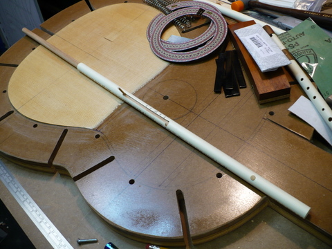

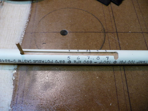

You mean, like this, sort of?
I saw something similar on a website showing a similar type of go-bar that a student of Romanillos was using, and found out that Romanillos uses a similar type.  Mine is a simpler form than the one I saw.  It is not quite finished yet, and this is the prototype of my design.
