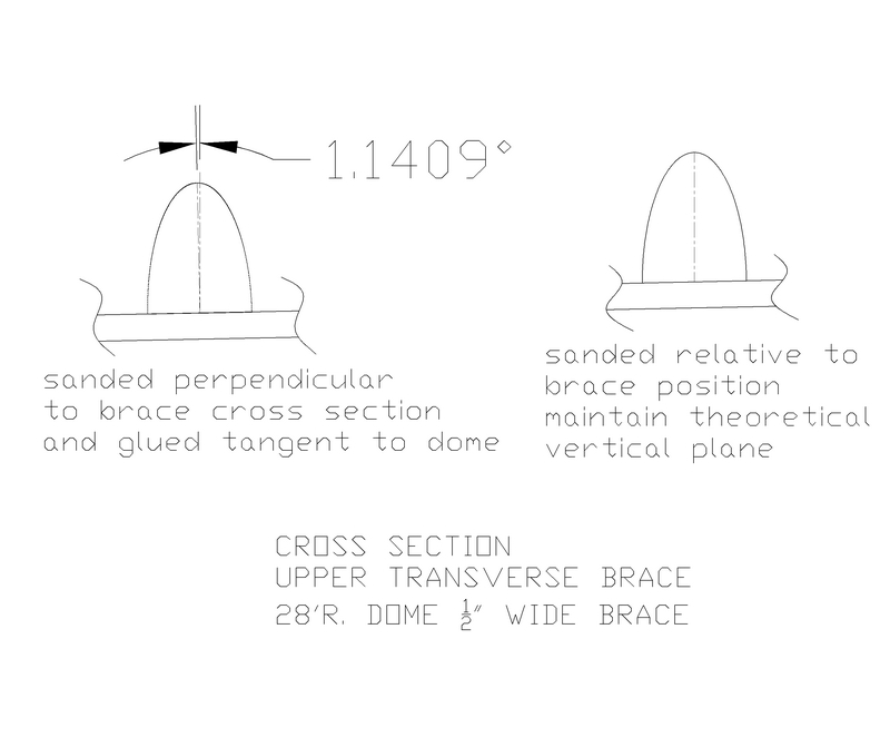

PostPosted: Thu Oct 04, 2007 1:59 am
It only boils down to "If you want your braces vertical plane to be tangent and perpendicular to the dome or not.
if you take a given radius brace and attach it at any point and in any orientation on a matching dome then the cross section of that brace will be tangent and perpendicular to the DOME.
Now if you want all your braces cross section appear to be coplanar with each other then you would have to sand them to shape in their relative position on the dome while hold and maintaining them in a theoretical vertical plane. this will impart the radius of the brace at a non-perpendicular angle in relationship to the cross section of the brace. but this can make all the braces coplanar in a theoretical vertical plane.
So not worth the time it is unreal. You will drive your self crazy with this
This is an over exaduration but if you sand in place maintaining a vertical plane then you end up with a cross section like this

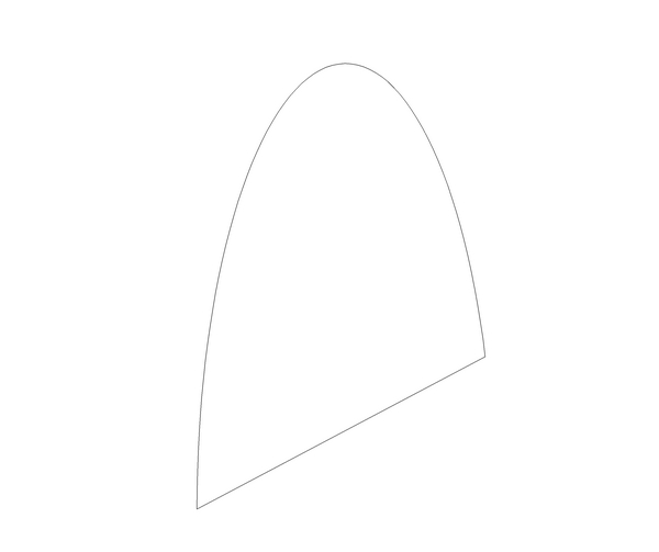

PostPosted: Thu Oct 04, 2007 3:03 am
Here is a comparison between a UTV brace sanded tangent to the dome. and one sanded in its relative glue up position maintaining the vertical plane of the brace to theoretical vertical.
Hardly seems worth the trouble to me

[QUOTE=MichaelP] It only boils down to "If you want your braces vertical plane to be tangent and perpendicular to the dome or not.
Excellent explanation Michael, and diagram. When this subject comes up next time, the poster should be directed to this thread.
