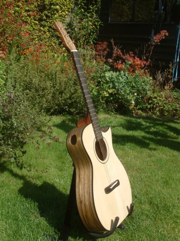

I posted some early sound clips from the Euro spruce/ Black limba guitar I made for the September 2007 Acoustic Guitar Show in Cheltenham and thought it was time to do another one to see how the guitar is “opening up”:
So here is “The Devil Rides Out” – two Breton Rides tought to me by the Flook guitarist Ed Boyd, They are in DADGAD Capo II, and the strings are the ones that were on at the show and have since had a month of heavy play from my daughter Suzanna who has “adopted” the guitar . This gives a fair test of the guitar’s sound rather than the strings. This was recorded with my usual set-up of an AKG C1000S microphone. It has flat EQ and a little added reverb. I really like the Black Limba and it definitely has that mahogany quality of good string separation and makes a good recording guitar. To my ear the guitar’s sound is becoming rounder and fuller. I’ll keep doing recordings at regular intervals to see how the sound changes.

"That guitar rings like a bell"  Beautiful full sound.
I am very impressed!

Dave,
I absolutely love the tone of this instrument. I can see why Suzanna wants to keep it.
The tone of this guitar is very sweet and lively. I actually held my breath in wonder when I heard the higher fret stuff 3/5ths the way through the sound sample. WOW, the guitar REALLY has opened up since I heard the real thing back at Cheltenham.
VERY well played I may add. I have got to get myself a set of Black Limba.
Well Dave, in my opinion, the tone of your guitars is on a par with my admiration of Lowden's guitars, if not better. Are you going to upload this sample onto your website?

Great stuff Dave, very mahogany sound from the guitar. Your usual playing standard of course. Penny and I tried the dance but I kept treading on her foot so nothing different there! My next steel tring is a Limba/lutz OOO, that give me great encouragement.

Walden - Thanks - I like this guitar a lot.
Kristopher - The Black limba came from Bob C and there's a lovely classical made by Renato Bellucci from Black limba that he shows on his website on the limba page.
Ken, Hesh, Mike - thanks
Sam - Thanks. The guitar is opening up really well and is getting me very close to the sound I had in my head when I started building. It's funny though - I was building long scale - 25.75" - for dropped tunings to get the extra string tension, but this short scale guitar - 24.8" - works beatifully and the trebles are just gorgeous. Live and learn . I'm looking forward to seeing how it sounds with new strings on.
Colin - Thanks. You'll love the Limba. It's a dream to work with and finish and I'm well impressed with it as a tone wood. As for the dance you have to remember that the Bretons dance on the right not the left side of the road
