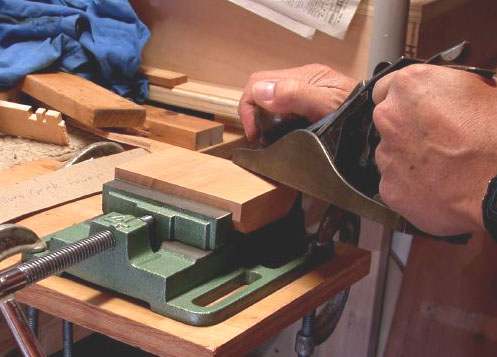

I use a plane, then touch up with sandpaper face up on the bench.
Perhaps not quite as accurate, but it works well for me. Plus I like using the old tools.
