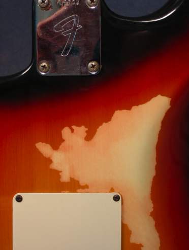

That reminds me...does anyone know what Fender used to spray as a primer...color wise...I have seen some cracked older instruments and they look like they had a layer of white or yellow in there somewhere.

[QUOTE=Dave-SKG]That reminds me...does anyone know what Fender used to
there somewhere.[/QUOTE]
I think that would be fullerplast.  Whatever it was...
+1 on the hand-etching.  If you look at vintage Les Pauls,
Teles/Strats and acoustics, you'll find three very different crazing
patterns.  The Fenders tend to craze along the grain, the LPs
across the grain, and the acoustics more randomly from points of stress
on the tops.
And none of them match the effect you get from those quickie cold-blast
treatments (which IMO looks more like a rock-through-a-window kind of
pattern).
PostPosted: Thu Oct 04, 2007 11:40 am
Posts: 2060
Right, Fullerplast was the brand of base coat / sealer they were using at the
time, though today it's always used as a generic term for that Fender yellow.
There's debate as to whether the Fullerplast sealer even contained the color
or was simply clear sealer, and differing accounts of how it was applied, but
that's another story. The yellow was applied on all early bodies whether they
were a burst or not, with the exception of Mary Kay or Olympic White guitars
that were set aside.
