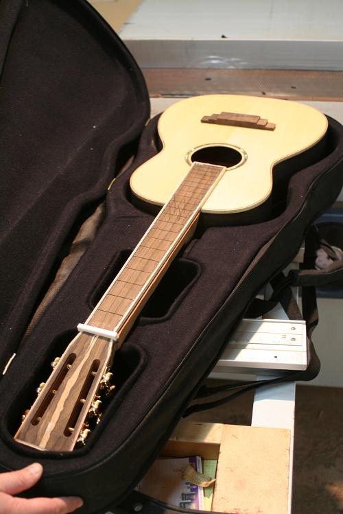

If you can wait a few months, I'll let you know. Here is my current project.

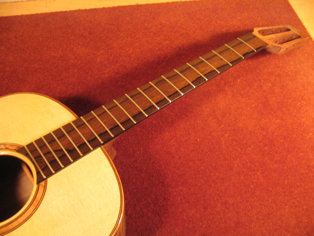

I've used it on one guitar so far, the one I built in Sergei de Jonge's class. No problems whatsoever in making the fretboard or installing frets. I haven't personally done any research into the hardness of ziricote compared with ebony or other good FB woods, but Sergei made a big point of recommending against using any wood for FBs that isn't extremely hard - he advised against using Indian rosewood, for example, which is indicative of how stringent his FB hardness requirement is. So, I figured, if ziricote is good enough for him, it's good enough for me.
This shot was taken in Sergei's shop. The FB was freshly oiled. It has darkened somewhat since then, but the colors are still lovely and you can still see the figure.
The guitar is now over two years old, but as for how it's wearing, I'm not a good one to test that, because I don't wear divots in FBs anyway. I've got these thick pads on my fingertips, so my nails never come anywhere close to the board, and I don't press so hard that the string touches the board, either. In my case, Indian rosewood or spruce or balsa or whatever would be fine.
