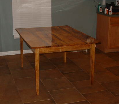

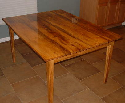

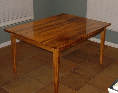

I built a kitchen table with it. REally didnt see any differences than regular maple. Of course you may find pockets that are in worse shape than the wood I had. Just use some polycryl or CA to  firm up the bad spots.
